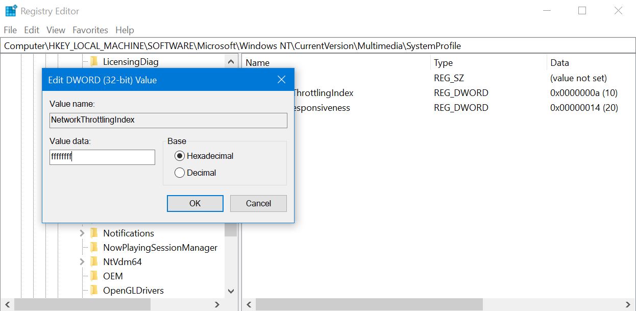

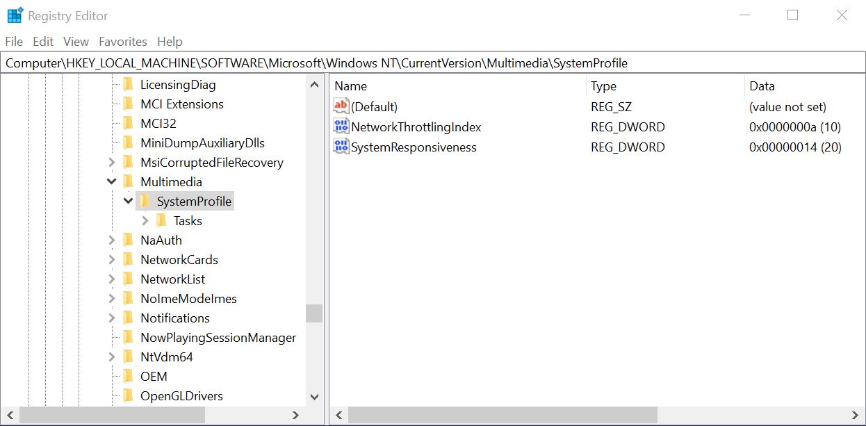

To change this setting you need to run the Registry Editor (regedit), then find the following registry key:
HKEY_LOCAL_MACHINE\SOFTWARE\Microsoft\Windows NT\CurrentVersion\Multimedia\SystemProfile
In that key you should find a registry value of type REG_DWORD called NetworkThrottlingIndex. It will have a default value of 0000000a in hexidecimal notation, which is 10 in decimal notation.
Double click on that value, change it to ffffffff (eight "f"s), click OK, close the Registry Editor, and reboot.
If for some reason you do not see a REG_DWORD called NetworkThrottlingIndex you can create one under the SystemProfile registry key by right-clicking in the right hand pane of the Registry Editor, selecting New > DWORD (32-bit) Value, creating it, then edit it as specified above.
That should do the trick. Not everyone notices a difference. If you experience problems, simply repeat the above instructions and change the value back to the default (hex "a", decimal 10).

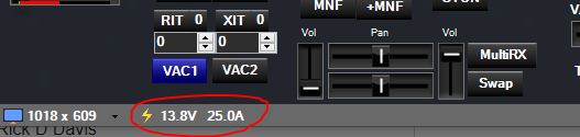

I have made these changes and now I have a Yellow lightening bolt with 13.8v 25.0A in the bottom LHS where it used to give me the CPU usage.
If I click on it it does not change or give me any information.
Any suggestions what it means,
John
Re: Changing Windows 10 Network Throttling Index for Better Performance
Posted: Sat May 22, 2021 12:07 pm
John--what version of Thetis are you running, and with what hardware (e.g. 200D, 7000, etc? Not only do I not see CPU percentage, but also do not see the antenna assignments on the status bar. This implies that you are either running an older version of Thetis, in which case you should update to 2.8.11, or if you are running 2.8.11 that the database or installation has somehow become corrupt. In either case this seems entirely coincidental to your registry change, which should have absolutely nothing to do with any of this.
FWIW, you can turn the volts/amps display on/off in Setup > Display > General.

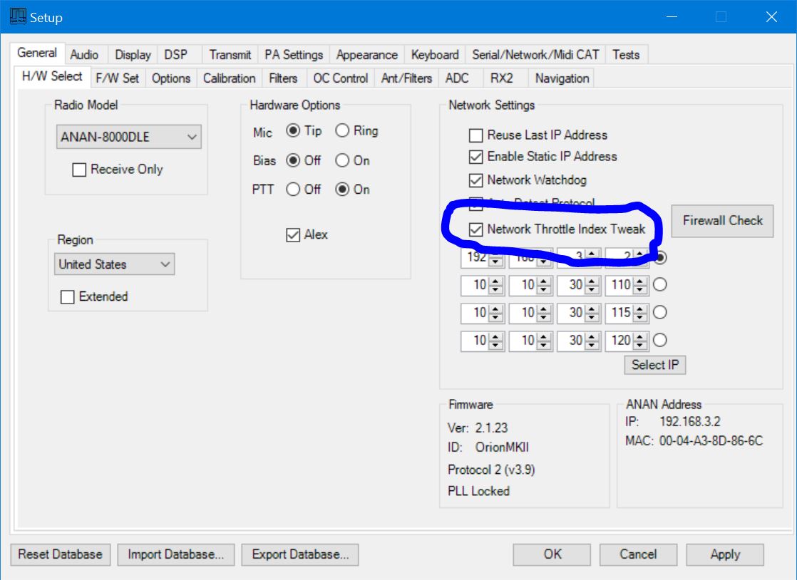

Don't forget, if you run Thetis as administrator you can change this right from within Thetis:
