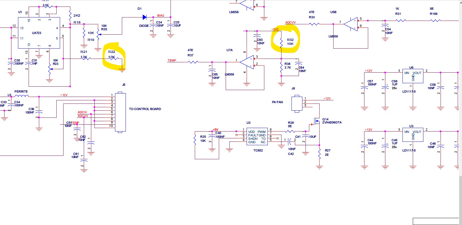

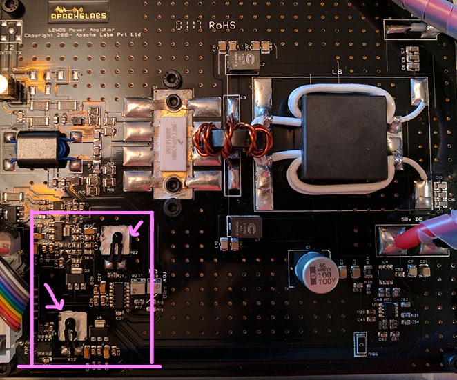

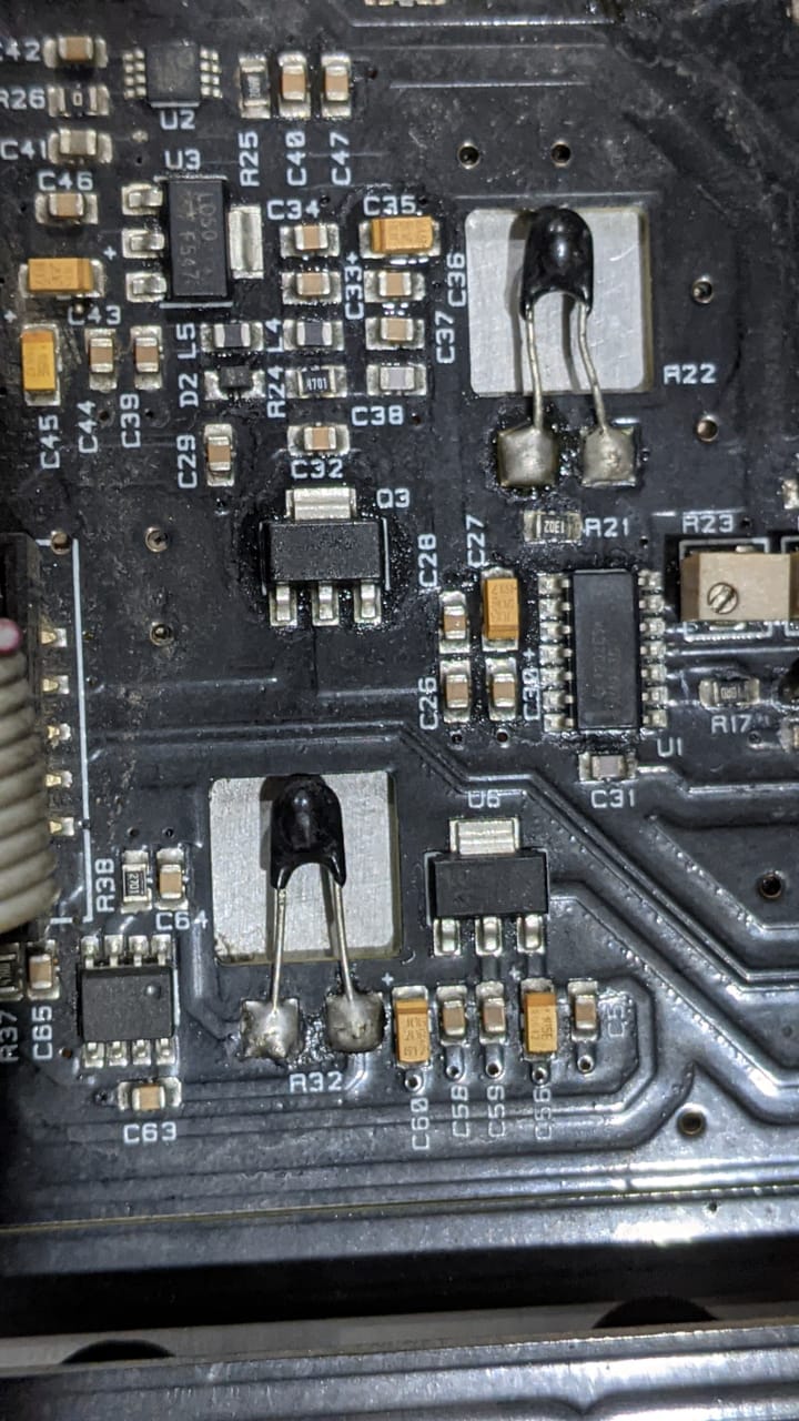

Today I was looking for something in various reviews of this radio and found one such review by Mark Abraham NI0Z of sdrzone (https://sdrzone.com/index.php/en/56-ana ... dle-review) and noticed the picture of amplifier board and noticed R22 & R32 are touching the heatsink compound to probably sense the temp of the heat sink and both the legs are insulated while in my board these are in the air above the slot on the PCB. Attached, please find both pictures. Please let me know if it would be beneficial in any way if I insulate the legs and put the heatsink compound in the slot and let the sensor touch it?
anan 8000 amp board schematic.jpg (157.7 KiB) Viewed 4243 times

I regret that I'm unwilling to pull my 8000 out of the rack it is in and disassemble it to see how it is built. Perhaps someone else might have easier access to their 8000?
However, it certainly looks like it ought to be built like NI0Z's.

Thanks for your response. Yesterday late at night I have done that already.
removed both of them and insulated the legs and put thermal compound in the slot
and now both of them touching the surface of the heatsink.
