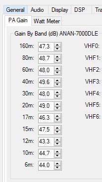

I've had to significantly alter some of the default settings in the PA Gain screen but I'm getting 100 watts out on all bands with the settings shown here:
PA Settings - Gain.PNG (122.79 KiB) Viewed 12213 times

Interesting Mark. My 7000dle MKII is the one in the large silver case with the two handles. I am unable to get 100w on the three bands mentioned. It just seemingly hits a hard stop limit when adjusting the PA gain values. I then back it down 5w or so. Somewhat strange, but has been there since 1st calibration when it was new.

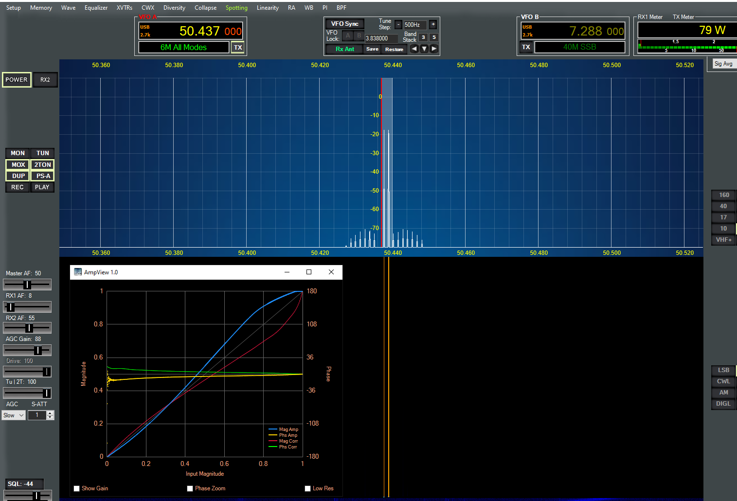

Edit: Upon further testing, something strange might be happening with the dummy load. The SWR is low and the VNA shows it's fine, but it doesn't seem to like 6m from the radio. Still though, power is somewhat reduced (50W) at the higher end of 6m when going into the tuner.
I'd like to bring this up again. Received a 7000 DLE Mk3. I recently stepped through the PA calibration steps, and the transceiver is making good power, except on 6m.
The following has been observed on both dummy load and antenna. All power numbers are with the drive set to 100W, and measured via tune CW.
From 50.000 to 50.400 I have full power available, 100W, then it starts to decrease, reaching 90W by 50.800. It continues to decrease past that. At 51.200 it's down to 80W, 75W at 51.5, 65W at 52.000, 47W at 53.000, all the way down to 35W at 53.900.
If I crank the PA cal on 6m I can get a little more power out but the amperage draw goes way high. I am supplying the radio with a regulated 35A continuous SMPS and short 10 gauge wire.
It sounds like this might be a manufacturing defect? An incorrect inductor? Does anyone have a new Mk3 they can check with?
I get a very strange graph from PS on 6m also, this is at 50W 2-tone into a dummy.

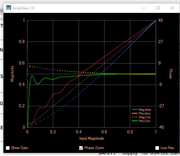

rdwing wrote:Bumping this...on my examply 6m transmit is super flaky. It generally down on power on the entire 6m band. Sometimes after hitting TUN it will xmit for a few seconds, then cut out with no power. Trying TUN a few more times might get it to transmit again, maybe not.
I have noticed that when this happens, the radio loses frequency lock and the calibration will be off. Hard cycling the transceiver recovers it.
These are all indications of bad SWR and/or a high level of RF on the shield of the coaxial cable causing RFI in the system. If you have the SWR protection enabled (Setup > General > Ant/Filters > Antenna) that may be part of it as well.
The dotted green and yellow lines in the AmpView display are indicative of bad feedback data. There is further evidence of this in the wavy green and red correction lines, they should be smooth. Again, these are all symptoms of a lot of RFI, a lot of RF on the coaxial shield, and that sort of thing.
It might be time to take a careful look at what is going on with the station as a whole, not just with the ANAN hardware. Grounding, bonding, absorption (ferrites on coax), SWR, connections, etc.

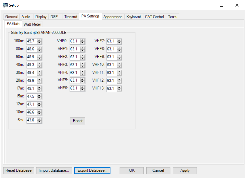

Right, so I found a bad PL259 and fixed that, I believe that was the cause of that Puresignal graph. That's been fixed now.
Still though, the low power output issue still exists. Both dummy loads have been analyzed on a VNA and they are fine, but I had purchased a second just to eliminate it as a factor. They are connected to the transceiver using 12" jumpers. The entire station has substantial choking and RF protection.
Something is wrong with this. I don't have any explanation on why PA cuts out or why its incapable of reaching 100W, unless I'm missing something.
Screenshot 2022-08-02 112144.png (244.94 KiB) Viewed 10106 times

The AmpView data looks a LOT better!
This is only a problem for you on 6M, correct?
If so, I'd recommend you contact the factory and/or US service (Doug, W5WC). It could be a fault with the 6M TX LPF.
