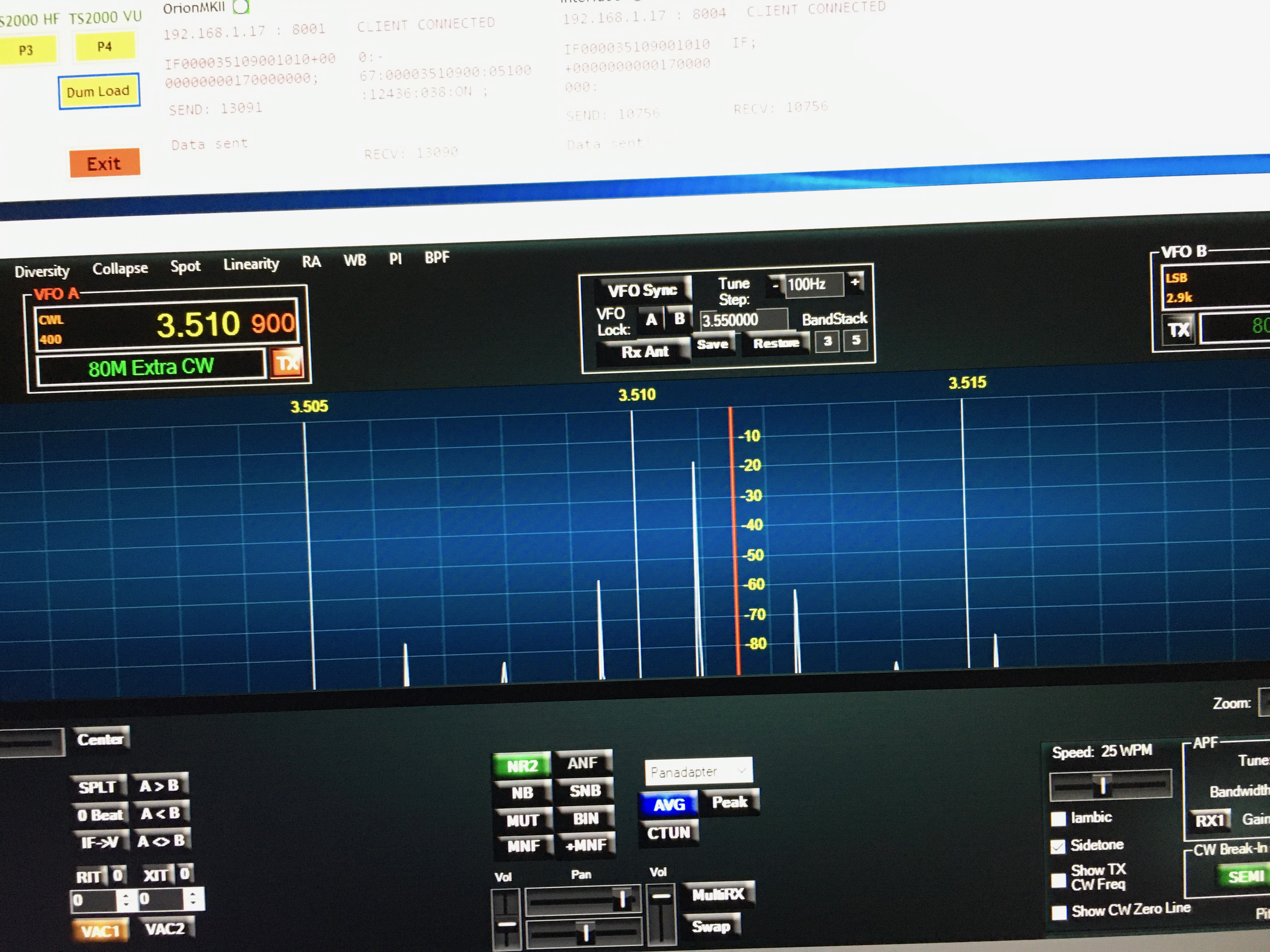

All,
I've encountered a serious spurs problem today on 80 meters band.
Please look at the picture showing the spurs on around 3.510MHz, 3.510 900. However, the spurs disappeared, e.g., on 3.508 800. This is
The firmware of Orion MKII is 2.0b, I think it is the latest. Thetis's version is 2.8.11. My H/W configuration is Orion MKII + Munin3. But the drive level is only 14. The cause of the spurs is not becaus of H/W, but software issue.
Is this phenomenon already experienced by others? Is there a new firmware to remedy it?

Re: Orion MKII Spurs on 80 meters band
Sorry, I forgot to attache the picture.
- IMG_0985.jpeg (2.89 MiB) Viewed 12801 times

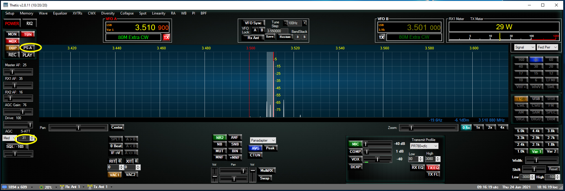

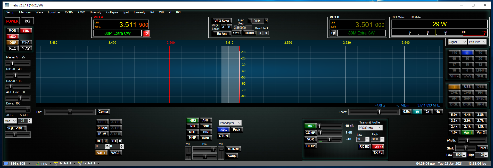

As for the request of Scott, I attache the two screen shots: one is the TUNE on 3.510 900 causing spurs, the other is that of 3.511 900 without spurs. This time the output power of Munin 3 is around 100W. Please disregard the Fwd Power 29W on the screenshots. Alex is checked in the setup panel but it is not connected. So this figure is incorrect. I measured 100W in my Drake power meter.
I could send the setup screen of Thetis. I use OCXO normally, but the result is the same regardless of the use of OCXO/internal TCXO.
So DUP is ON. But this is apparently a homebrew setup. What is the Orion RX1 looking at during TX? Do you have a coupler at the output of the Munin that is providing a feedback path and a switch that is switching that into RX1 during TX? In other words, are we really seeing the output of the Munin during TX? Assuming there is a coupler, what is the coupling factor in dB?
What does the output of the Orion look like before it goes into the Munin? Is that something that you can measure? Because it is more likely that these spurs are being generated in the Munin.
What is your drive level in Watts (not slider position)? Can you measure that? What happens if you drop that drive level by half (3dB)?
The spurs are below -50dBc which is damn good by any standard.
Thank you very much for your input.
--> Yes. We see the output of Munin3. A small relay inside the sampler switches a feedback path to RX1.
--> I use DC6NY type sampler. This works very fine with my 1KW amp as well as with Munin3 for Pure Signal. So, the coupling factor is around 30dB, then some attenuation inside the sampler. S-ATT during 1kW output is around 4-5dB.
On 3.510 900, I can see the spurs, on the contrary no spurs on 3.5111 900 or other frequencies, but I don't know how extent it is. This is a reality.
The spurs is around 50dB down, then it would be OK for the new spectral purity regulation. However, this kind of spurs would be ameliorated.
Do you have the similar spurs or not on this frequency?

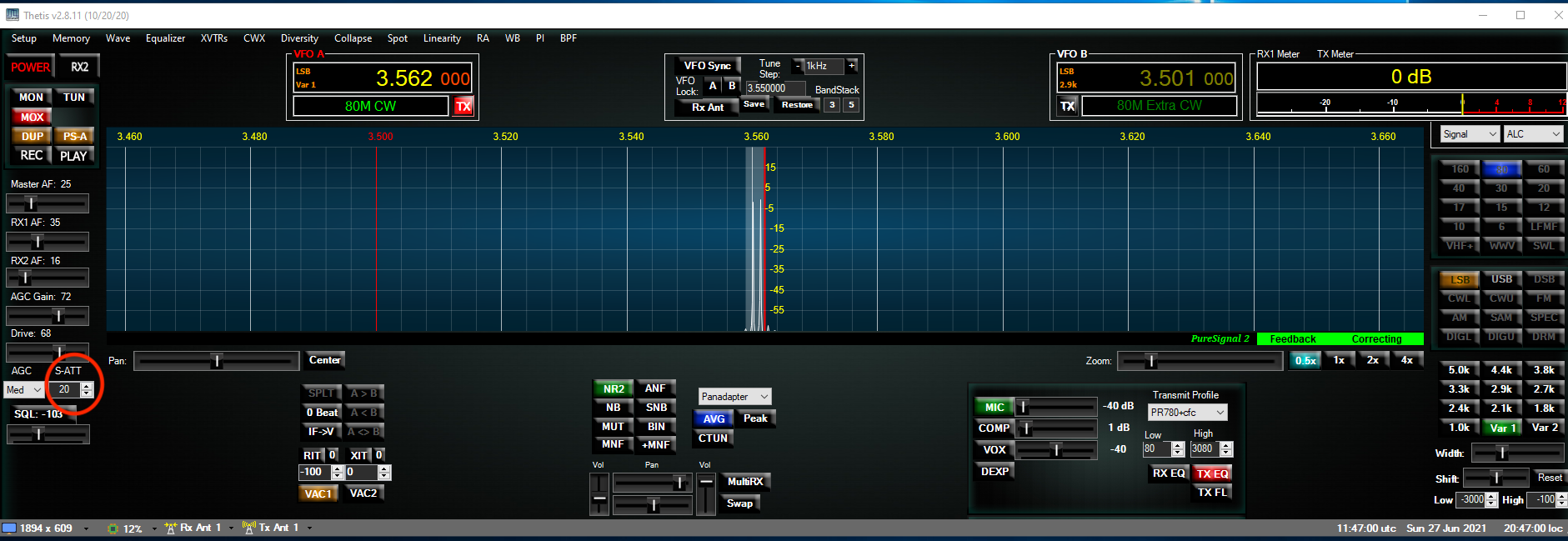

Tokio,
I notice now that your S-ATT setting when using TUN is 31dB, and the tone power is -15dB. That means the power level at the Orion RX1 input is +16dBm, which is far too high. Indeed, anything over +13dBm is potentially dangerous. You may be seeing IMD occurring in the receive path. So instead of taking some attenuation out in the coupled/switched path, you may actually want to be putting some in.
This is a bit strange, however, because with two-tone at 1KW you are only seeing an S-ATT of 18dB. This implies an RX1 level of +7dBm (total of both tones, each tone by itself 6dB less) and a total loss in the coupled/switched path of -53dB. And, of course, the values at 100W are almost exactly 10dB less, just as expected. Under those conditions you should be unconditionally safe for any power level 1KW and below, and at 1KW a CW signal (not two-tone) would have an power level 6dB higher.
What is different about the TUN cases?

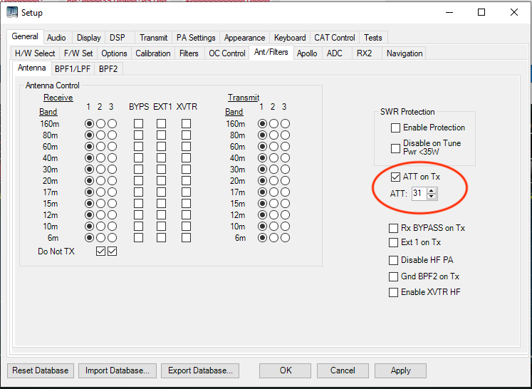

This evening I checked the spurs on 3.510 900 which was shown in the previous screenshot. You mentioned 31dB S-ATT on the picture.
31dB is set because that ATT on TX is set to 31dB in the setup panel << General->Ant/Filters->Antenna >>. In addition, this is TX by TUNE. In TUNE transmission Puresignal is not active, even PSA is enabled. Though, I set PSA disabled as in the picture.
One thing I found strange about this option is the following:
I changed the value from 31dB to, e.g., 25dB. Then I clicked TUN button. S-ATT is 31dB, then I see this option. The value becomes 31dB.
Maybe there is some tip to keep this value to 25dB in the setup panel. But it is beyond of my experience.
Hope my post will clear your question.
Tokio
JA1CCA
Tokio
JA1CCA
- 3510900 spurs.PNG (531.64 KiB) Viewed 12531 times
- Option_Antenna.PNG (55.82 KiB) Viewed 12531 times
According to your advice about feedback level, I increased it by 2dB this time. My sampler uses 2 stage ATTs after Tandem match, 23dB, and 2dB. I removed 2dB ATT. For 23dB, I use 56 ohms 1W chip resistor (56 - 330 - 56: 23dB pi ATT) . To get 4dB increase, I have to replace this 23dB ATT by using other values. But I haven't the appropriate ones, such as 61dB 1W resistor. So I have to be satisfied for the moment with this feed back level.
As you can see the attached picture, the improvement of Pure Signal is evident. S-ATT becomes 20dB from 18dB for 1KW. I try to change the value in due course .
Thank you very much for your good advice. BTW, it would be very much helpful to understand the Pure Signal, if you could explain why this feedback level is needed to get the good result?
Tokio
JA1CCA
Tokio
JA1CCA
- PureSignal Improved.PNG (521.01 KiB) Viewed 12463 times
- S-ATT puresignal 1KW.PNG (568.77 KiB) Viewed 12463 times
