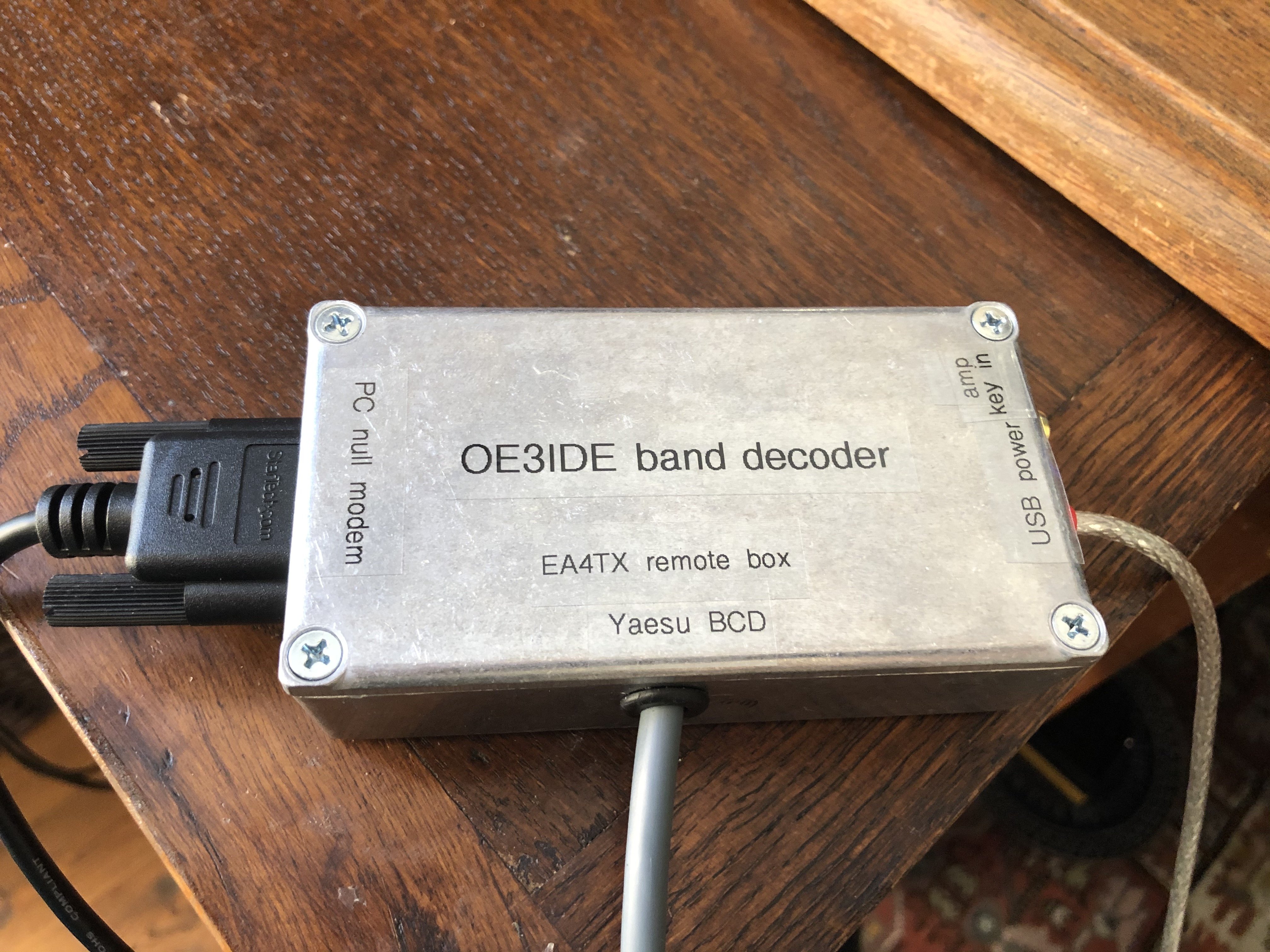

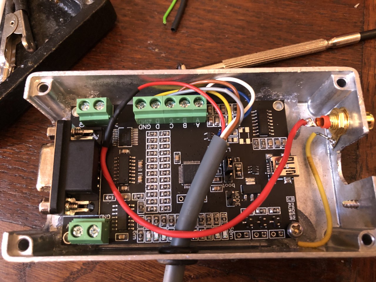

Just finished my last little project. I have a remote antenna switch from EA4TX. The controller is accepting band data in Yaesu and Icom format.
The universal band decoder converts the regular Kenwood cat-data into BCD or Icom Voltage band data. So the RS232 is connected to the PC (COM5). In Thetis I have activated this com port.
The decoder polls every 500ms (sending "IF;") and sends the band data to the EA4TX-Controller. Amp-key-in is for protecting against hot-switching.

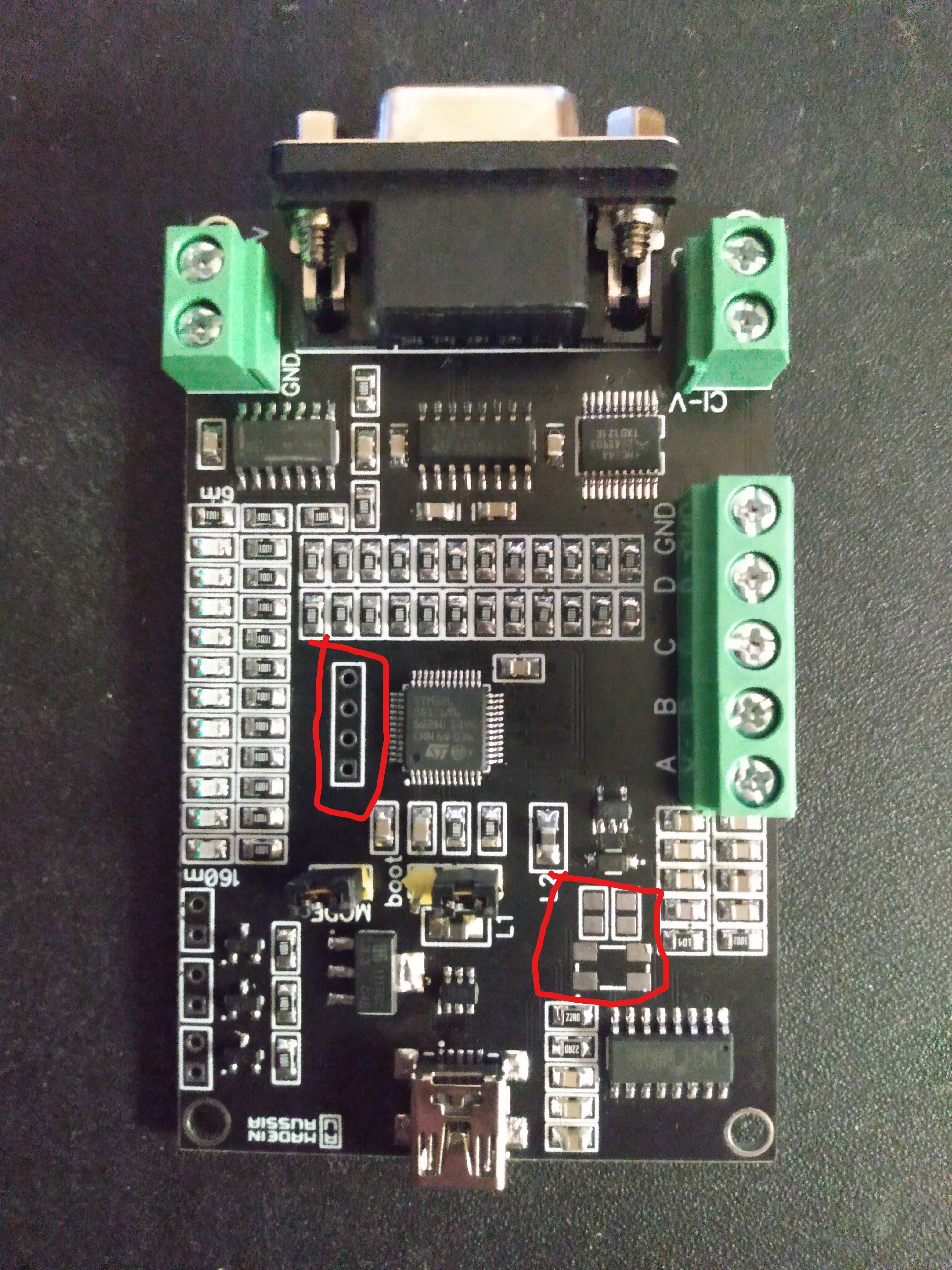

I do have a question about a couple of things I am noticing on the board. There in a 4 pin solder pad near the cpu. No documentation I can find mentions it and not on the schematic. Also near the USB connector is two areas which look like solder jumper pads. Any clue what they are for?
The with/without Mode Logger jumper. Is it simply a means to disable date on the USB jack?
Unfortunately I didn't realize he used a mini USB connector and I don't have a cable to fit. I will have to wait to test it.
