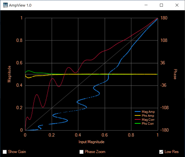

Here's the PS results obtained on 20 meters, which don't look anything at all like the behavior on any of the other bands:

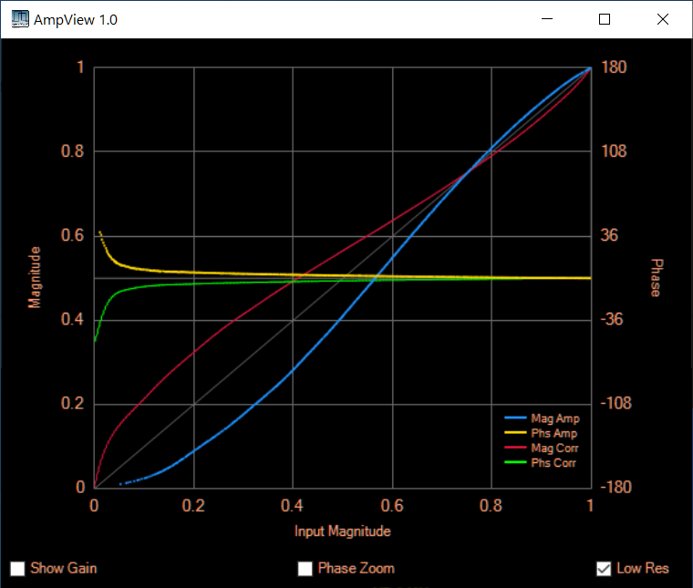

Compare that to 17 meters:
17m PS.PNG (93.06 KiB) Viewed 4146 times

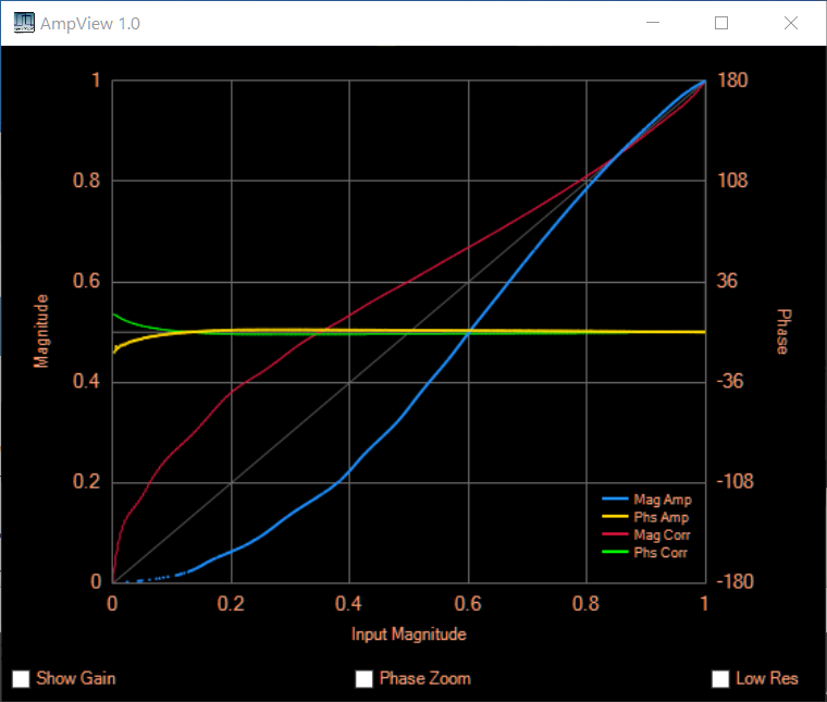

And 40 meters:
40m PS.PNG (91.57 KiB) Viewed 4146 times
To be honest, when PS first "locks on" to the signal on 20 meters, for the first second or so it does function as one would expect, generating amplitude and correction curves that appear virtually identical to the curves on the other bands. However, within a couple of seconds the curves rapidly deteriorate into the ugly distorted curves shown in the 20 meter pic above. Also, the splatter reduction starts out very good, but just as quickly degenerates into a quite ugly transmitted signal.
What I do as a workaround is to simply use Single Cal which (almost always) does lock onto a good set of correction curves that look just like the curves on the other bands, and the splatter reduction is also very good (very similar to that on the other bands).
So PS appears to be functioning as designed for the first second or so, which suggests to me that it's not a hardware problem (but I could be wrong).

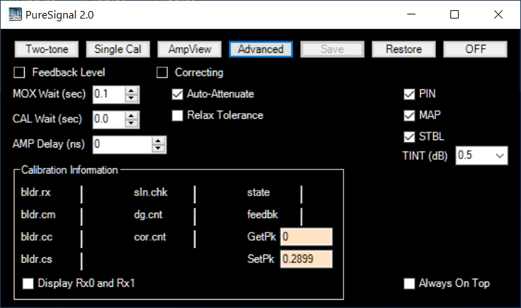

For what it's worth, here are my PS settings:
Typical PS Settings.PNG (85.59 KiB) Viewed 4146 times

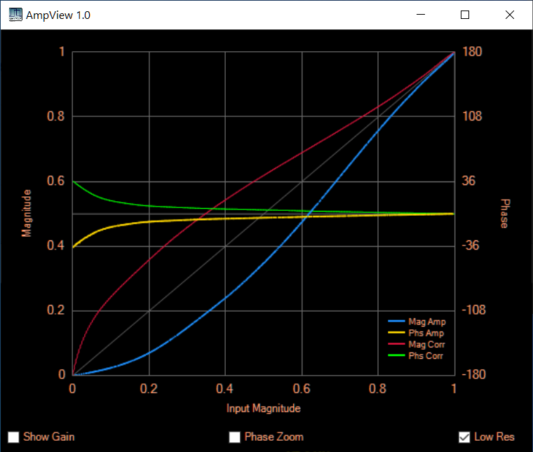

And here are the results:
This is 50 watts barefoot thru the built-in sampler:
20m at 50w barefoot thru built-in sampler into Versaload.PNG (86.87 KiB) Viewed 4140 times

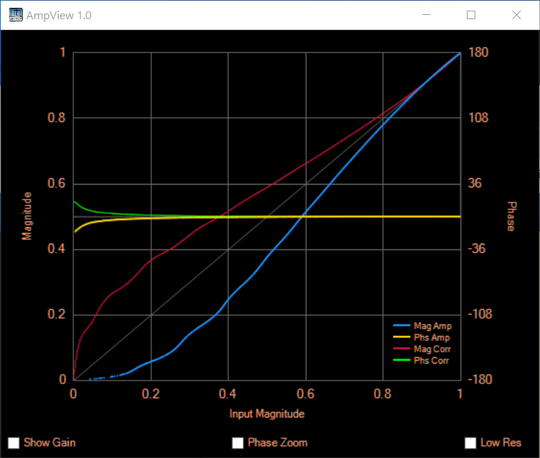

And here's 750 watts thru the external sampler:
20m at 750w from amp thru outboard sampler into Versaload.PNG (89.23 KiB) Viewed 4140 times
As you can see, both graphs show much cleaner curves, and the splatter on transmit is very clean in both cases.
So the only conclusion I can draw is that the 989D tuner is somehow corrupting the PS algorithm in Thetis, because if I take the tuner out of the picture then PS behaves as it should.
That means I need to find a solution to the tuner corrupting PS, but at least I know that my radio is working correctly (which is a relief)!
