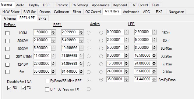

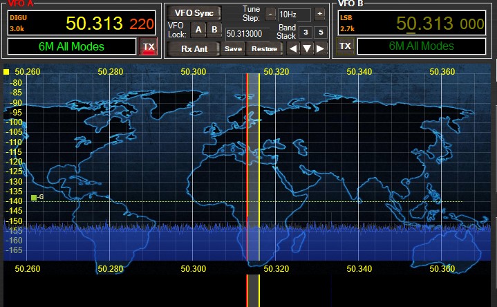

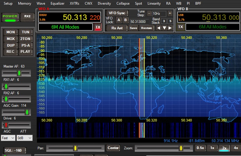

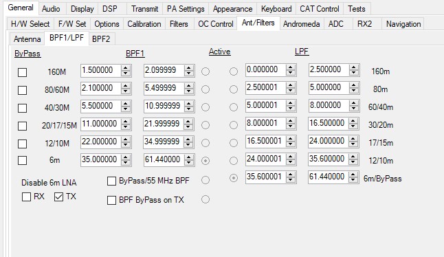

I fear my 6 m LNA is dead.
I was receiving 6 m band during a far thoundstorm and suddenly the receiver drop gain of about 40 dB.
Below pictures of today situation.
Setup LNA ON.jpg (67.41 KiB) Viewed 8273 times
LNA ON.jpg (109.22 KiB) Viewed 8273 times
Setup LNA OFF.jpg (67.29 KiB) Viewed 8273 times
LNA OFF.jpg (155.53 KiB) Viewed 8273 times
I think the LNA is dead.
When I switch in setup between the 6 m LNA ON and OFF, I hear a relé click everytime.

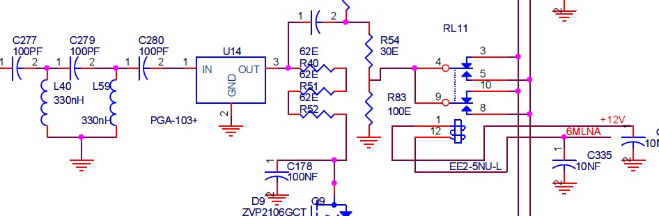

Where is located the 6 m LNA component? Someone has a picture of the board and location of it?
Just today I received the schematics. I think the component is U14 and/or U15 (PGA-103+) located on PA Filter board.
6m LNA.jpg (62.72 KiB) Viewed 8273 times
Do you suggest other tests to prove it is really defective?

After some bad words :D , I was able to change U14 and now the RX1 6 m LNA is working properly.
I found the component case broken, like a short circuit on power supply inside it.
Not understanding why this happened.
It may be a defective component not enough seasoned. ;)
