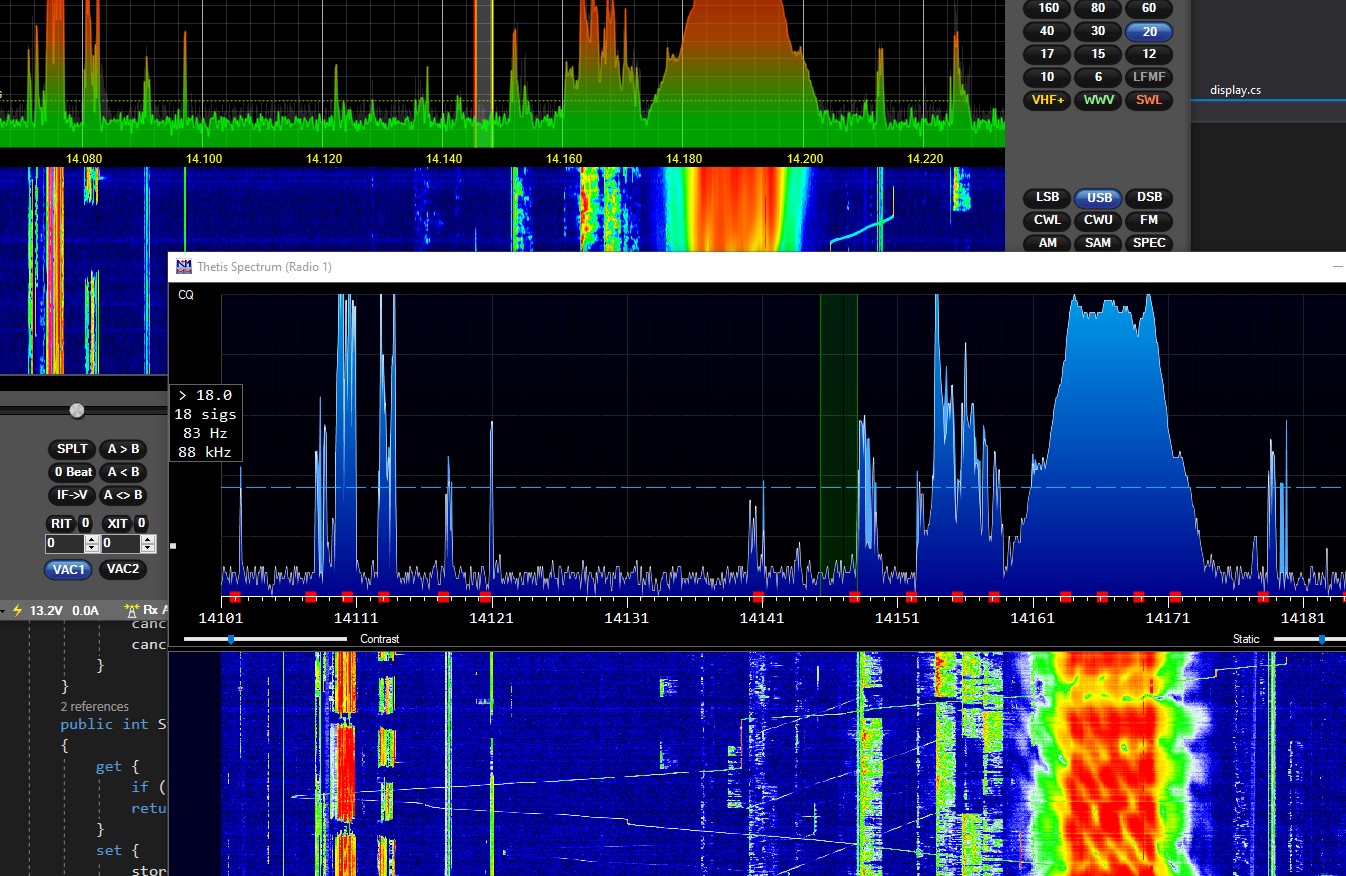

Basics working... for now it just uses the data from RX1 display. The view will be sent to n1mm. I guess there is a need to send rx2 data as well?
I did start down the route of creating an entire new receiver that would send whole sample rate width over to n1mm, but the XML doc got somewhat large
So instead, whatever you have displayed on thetis, will show on n1mm.

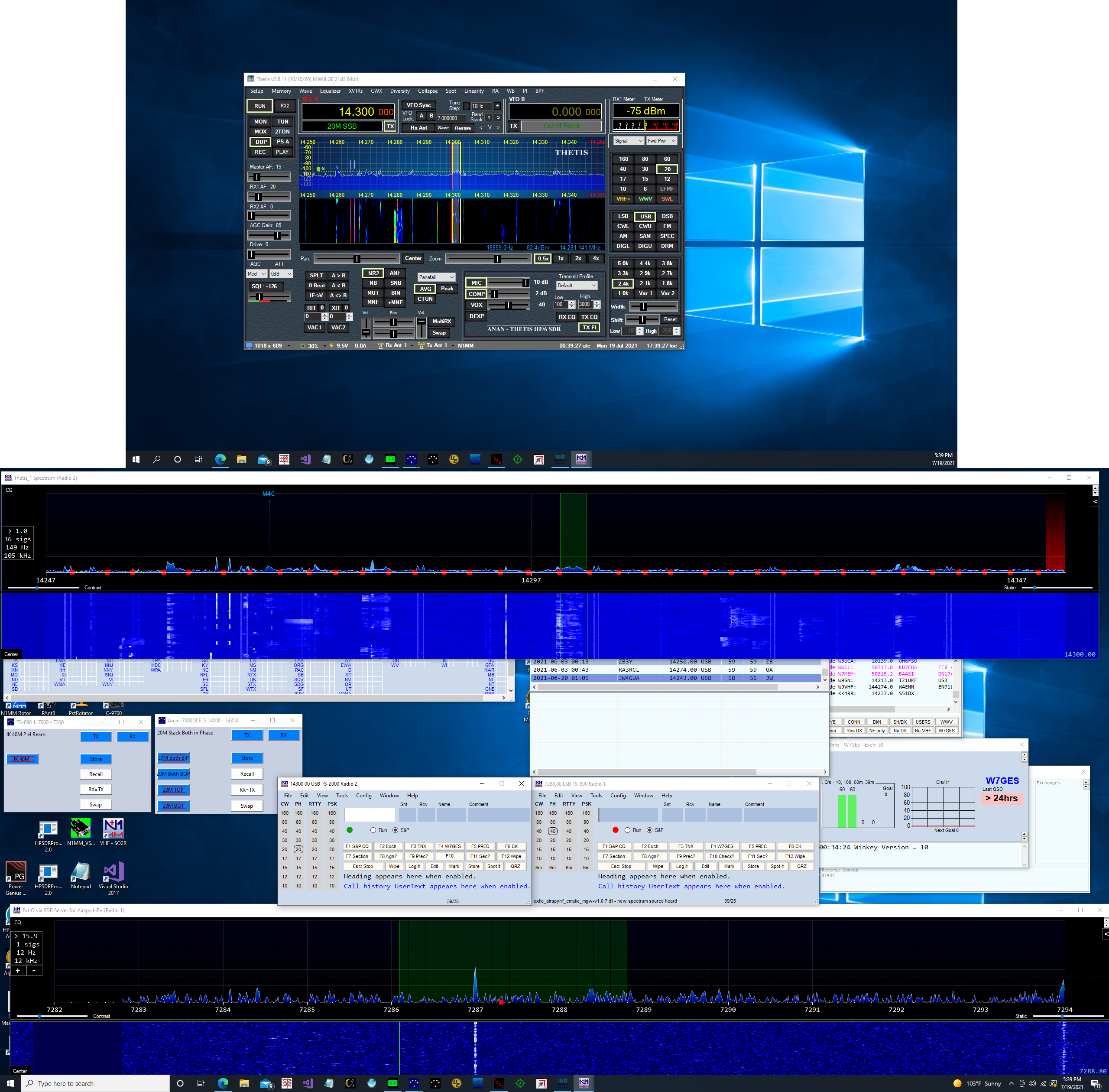

That looks great! In my case I will only be using RX1 as I have a conventional radio I will be using for the other source when I’m running SO2R.
There may be others that would like to use RX2, I know there are some Flex owners that use their rigs that way.
I think having a mirror of the Thetis display on N1MM is intuitive for setup purposes. If there are separate sample rates for the N1MM display and the Thetis display there will be questions why they look different. For my TS-890 and my Icom 7300 the sample rate width matches the selection I make in the radio. I’m guessing this uses less CPU overhead than creating a new receiver as well?

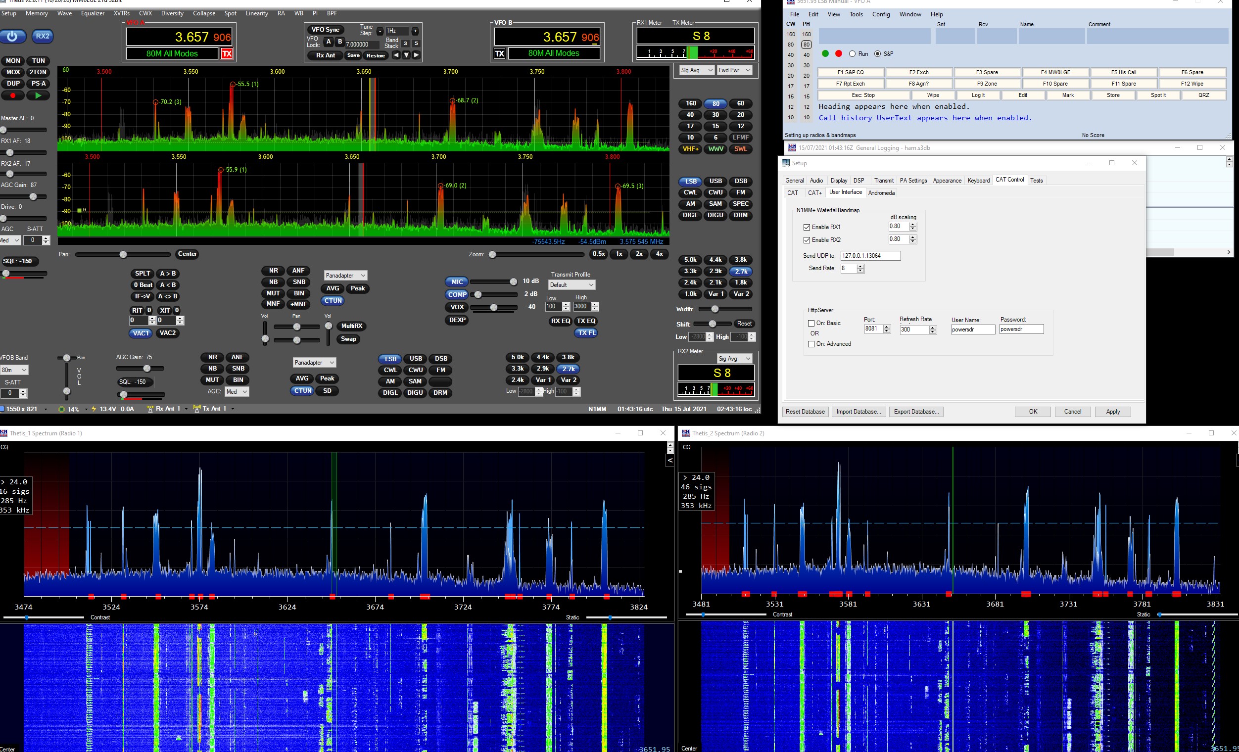

It's working great here. This is monsoon season in the AZ desert so I had to reconnect my radios, computers and antenna relays to test it out.
