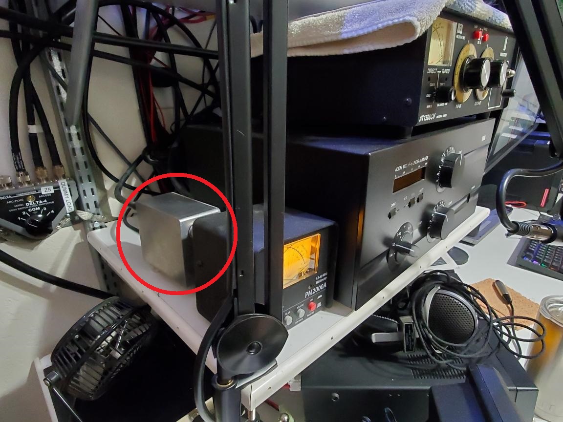

I built my own pure resistive non-directional sampler (I have no need for a directional sampler) from a handful of 2-watt 12k-ohm carbon composition resistors and a Hammond 1590C enclosure box. Total resistance at the tap is 18k-ohms. Not sure what that equates to in terms of dB attenuation but it works fine for any power level between 25 watts and 1 KW (all my AL80B can deliver). I decided to go with a pure resistive arrangement to avoid any capacitive or inductive reactance influence to the PureSignal algorithm.
Here's a link to several pics I took of that project. Disregard the variable pots in the enclosure (those were installed for development purposes and are no longer part of any circuitry), and you can probably also disregard the smaller resistors in the circuit as they make a negligible difference in the 18k-ohm value of the total resistance.
https://drive.google.com/drive/folders/ ... sp=sharing
Basically it's three pairs of parallel 12k resistors (each pair being 6k equivalent) connected in series, so the total series resistance is 18K (3 times 6k). I determined empirically that 18k served my purposes well, and left plenty of attenuation headroom still available in Thetis to run full legal power if desired (if I recall correctly my PureSignal auto-attenuate level in Thetis is 18dB at a transmit power level of 1KW using that sampler).
Another 7000DLE MKII user in the area asked me to build him a box just like mine and he's plenty happy with his. Here's a pic of his installed in his shack, he's running at least a KW:
