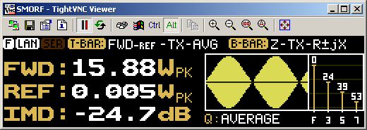

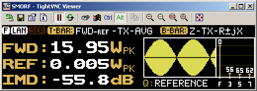

No LP-500 but a Microham SMORF.
It can measure IMD quite good, along with many other things.
Smorf PS On.png (6.77 KiB) Viewed 4776 times
Smorf PS Off.png (6.79 KiB) Viewed 4776 times
