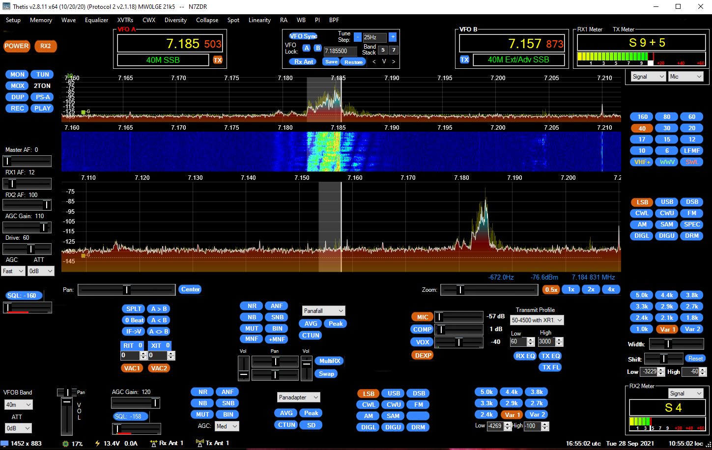

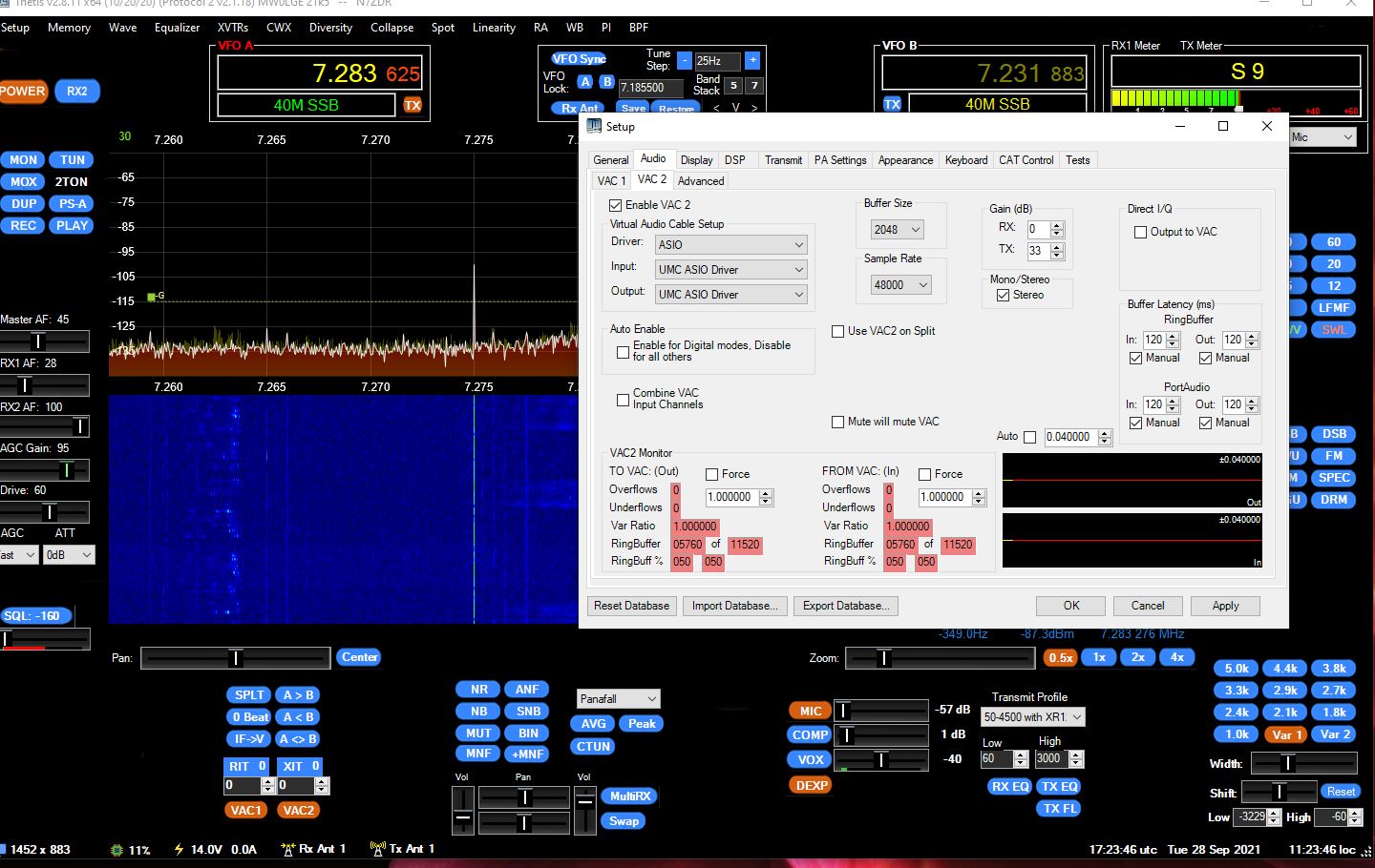

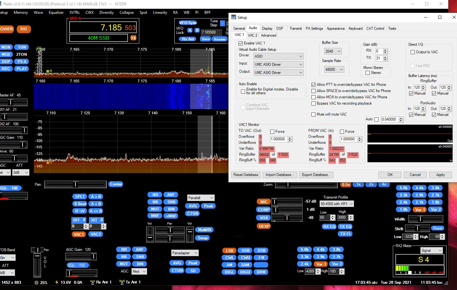

All worked ok before-- never really did anything that I know of. Surely I am missing something somewhere!

vac2 device?
Re: No 2nd Recieve Audio!
That's normal, are you using ASIO drivers in "exclusive mode"?
good spot Jordi. This is something I did not realised. I have vac2 on MME driver using same device.ea3aqr wrote:That's normal, are you using ASIO drivers in "exclusive mode"?
Yes, this always been a limitation of PowerSDR and then Thetis. The portaudio implementation in Thetis only allows a single instance of ASIO, so you can use it on VAC1 or VAC2 but not both at the same time. Put that on the "want" list
However, I have done some experiments here in the past. You can use ASIO on VAC1 and WDM (faster than MME) on VAC2 and mix them both in Voicemeeter to get a composite output of both RX1 and RX2. If you then assign RX1 and RX2 to the same frequency, you can appreciate just a tiny bit of reverb, i.e. just a tiny bit of delay from VAC2/WDM compared to VAC1/ASIO. This is also a great way to appreciate how much delay NR, NB and EQ can cause on the received signal. If you hear a distinct echo, be sure that, for example, NR2 is not turned on on RX1 and not on RX2, etc.
