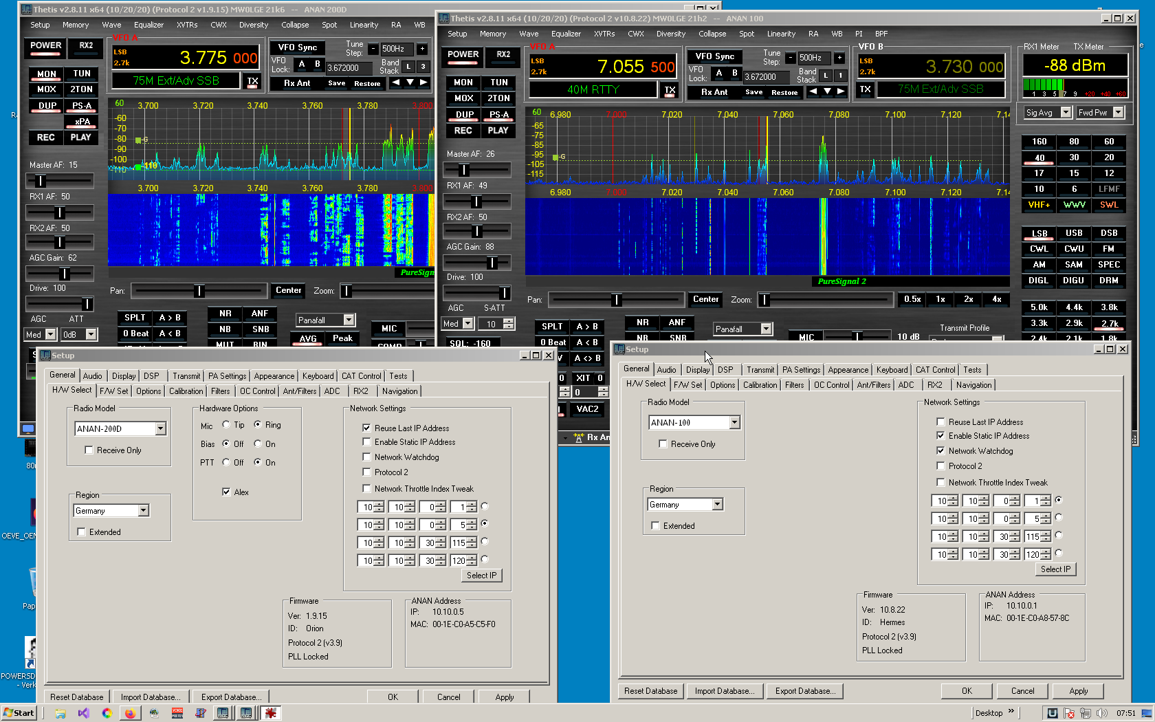

I do use two rigs simultanous on a regular basis.
The rigs must have (different) fixed IP's assigned.
The two Thetis instances must be started with -datapath options pointing to the appropiate databases (with fixed IP's and Radio Models configured).
The PC should be fast enough to run both radios with not more then 50% processor load, two 1Gb network interfaces ( one for internet and home network, another for the radios and other ham hardware) are prefered.
73 Walter

ANAN100 10.8.22
ANAN200 1.9.15
Dual Rig.png (418.51 KiB) Viewed 7985 times
