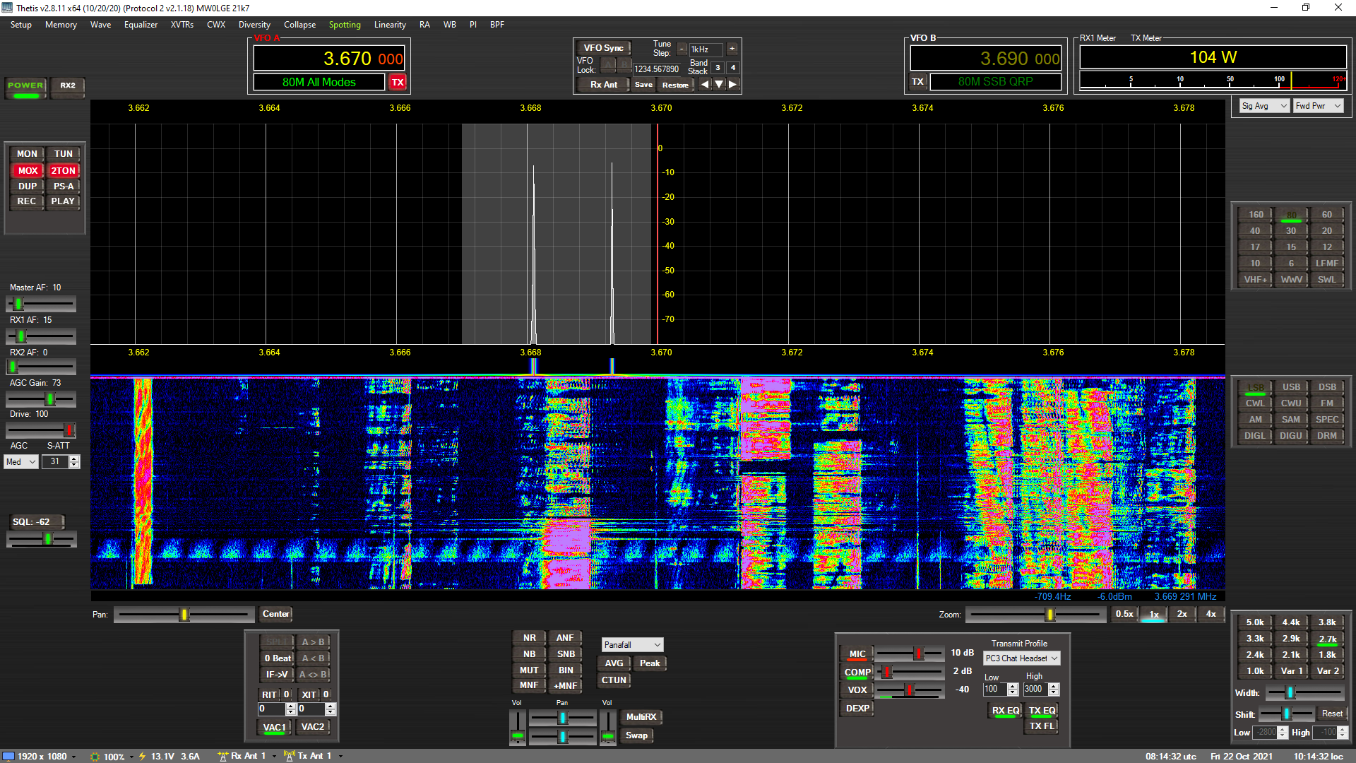

What does it show when you use the 2TONE button?
Pls give a full screenshot when transmitting with 2tone test.
Re: Anan 7000DLE MKII: voltage/current reading in Thetis
Hi Leon,
A screenshot with a two tone signal is attached. The power supply indicates about 12.5A total (80m). The on-screen reading is 3.6A which is too low. WIth a single tone (Tune) the Thetis display indicates 6.6A which is too low either. I probably need to contact Apache Lab's support. I do not intend to replace a chip (ACS713) in a brand new transceiver..... But well, without Thetis I would have never noticed this issue.

- 2021-10-22.png (1.08 MiB) Viewed 10525 times
