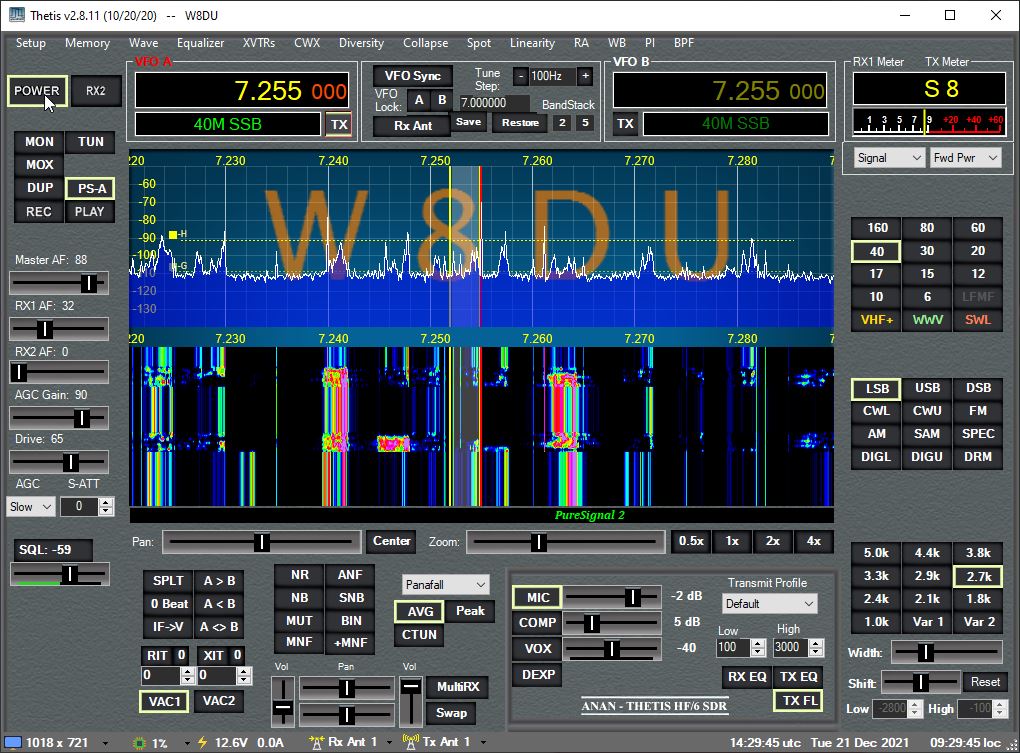

I have not used my Anan 700DLE Mk2 for a couple of months. I have Thetis 2.8.11 installed on my W10pro computer. Firmware in the radio is
Metis_Orion_MkII_Protocol_2_v2.0b. All working fine before. Now, when I ran Thetis, it starts up properly but only works for a second or so. Then it stays open but does not receive. I will attach a screenshot.
Does anyone have any ideas as to how to fix this problem? I have tried reloading the firmware and resetting the database. I don't think it is a software problem becuase the same think happens when I run the same version of Thetis from another computer on my network.

Well, I figured it out. It was an IP address conflict on my LAN. It seems that in the interim between using the radio, another device was assigned the same address as the radio was using. Once I figured that out, it was a simple matter to assign a new IP address to the radio and then make it reserved in my router DHCP table. Phew!!!
