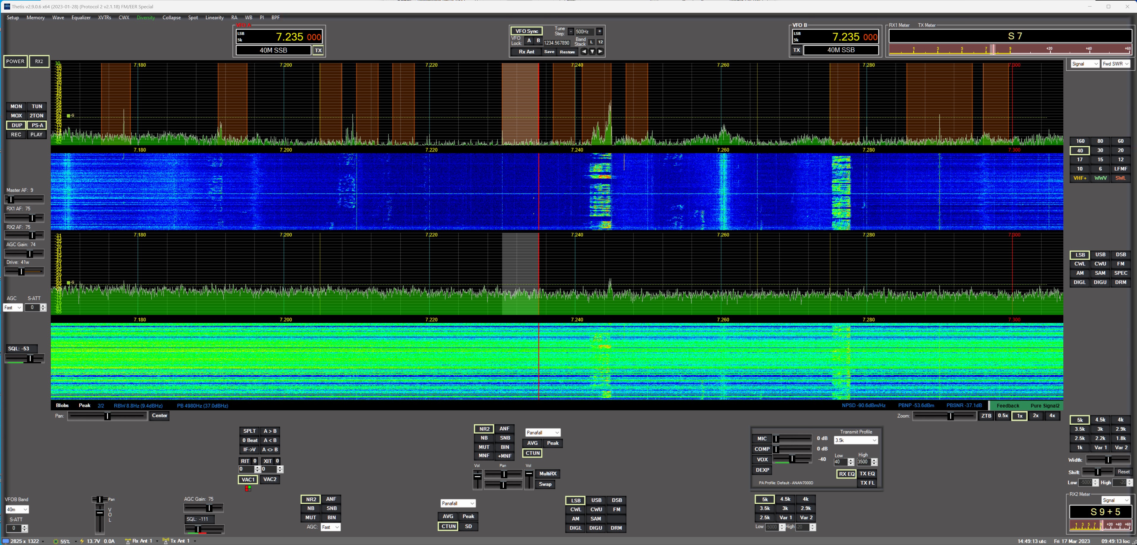

George,
Not to jack this thread but I use Diversity Receive to eliminate any single point source of electrical RFI regardless of whether the interference is wideband or birdie.
Here's a rather extreme example of wideband interference caused by a single point source, and how effective Diversity mode can be in eliminating the interference.
A storm came through Thursday night and the result the next morning was as shown below. RX2 shows severe wideband interference effectively rendering the entire band unusable for any amateur activity. The upper receiver shows the interference completely eliminated, at least at the frequency of interest (7.235).
Note that the reduction is not total when viewed across the entire band (the interference is still visible at both band edges), but is tunable for max effectiveness at any desired frequency.
