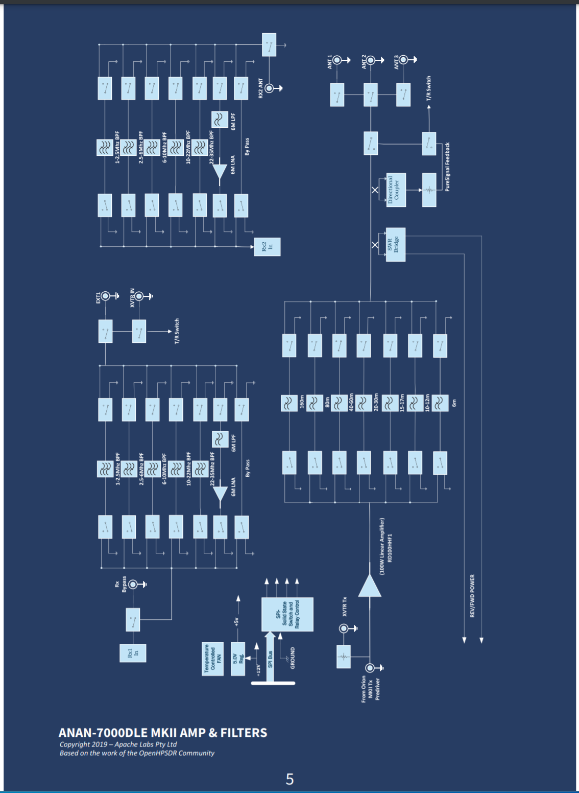

What specifically are you referring to by the term "preselector"? If you mean band prefilter then I'm confused, because you say that the 7000 has no ADC2 prefilter but the screenshot below (taken from the Anan 7000 black-case brochure) shows full prefilters for both RX1 and RX2.
Please clarify,
Please clarify,

Re: Difference between a 8000DLE and 7000MKII
My apologies! I thought the 7000 didn't have a preselector on the second ADC, but per that block diagram it clearly does. So there you go, even less of a difference between the two models!
I've edited my post above to make that correction.
Not a problem Scott, I do believe that's the first mistake I've seen you make in the entire time I've been on this site!
It just confused me for a sec because I was sure I'd read before purchasing my 7000 that both ADCs had full prefilters. In fact, that was one of the plusses that drove me to make the purchase....that, plus PureSignal plus Thetis plus the support team (including you!) plus everything else that's so awesome about this radio!

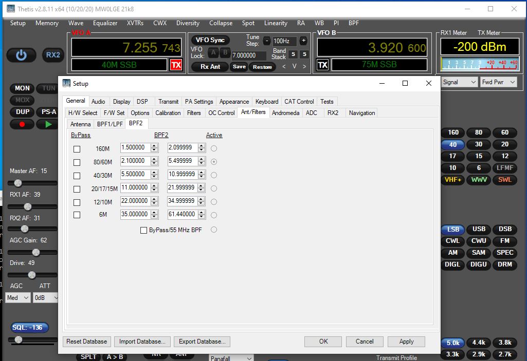

I believe you can change the RX2 BPF's here:
-Rick / N1GP
-Rick / N1GP
Yes, I see that.
Thanks Rick.
73 Tom
Thanks Rick.
73 Tom
