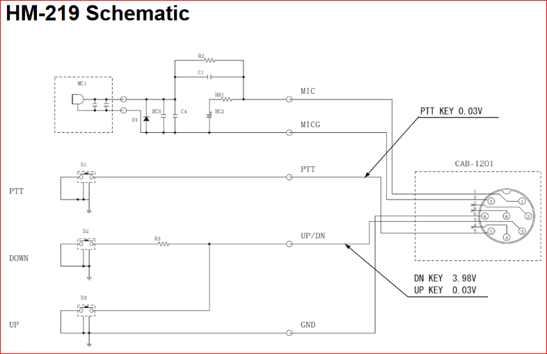

Previous owner said he used a "mono" :shock: plug with a dynamic mic. I wanted to do the bootloader switch mode JP17 so I opened her up to have a look and found JP4 using pins 1&2, Nothing on JP5 and JP6.
I would like to try the HM219 which is a good sounding mic on the Icoms. I planned to make a short lead 8pin>TRS but if someone could check them for me and correct where needed I would really apprecite it.
1) Move jumper JP4 to use pins 2&3 (Tip)
2) Connect Pin1 on Mic to TRS Tip
3) Place Jumper JP5 to use pins 2&3 (Enable Bias Mic on Tip)
4) Place jumper JP6 to use pins 1&2 (PTT on Ring)
5) Connect Pin5 on Mic to TRS Ring
6) Connect Pin7 on Mic to TRS Sleeve
I do have doubts and wonder what powers the electret that usually comes from Pin2 but would this work and how to make it so.

Paul,
Mic bias from the ANAN is approx. 2.5V. See this discussion: https://apache-labs.com/community/viewt ... =12&t=2612
That might be a little low to get full output from the Icom mic, as I believe it is 8V on Icom radios. But worth a try. If it doesn't work, just use the mic from your 7000. In fact it might be less work to build/buy a switchbox.
One detail you missed is that pin 6 needs to go to the shield also. If you look carefully you'll see it's a separate ground in the mic, separate from the mic element ground.

Morning Scott,
Thanks for the reply.....I get the voltage is low ;). I had thought about only moving JP4 to Pins 2&3 Tip and leave JP5&6 off that way it should be exactly the same as my 7000 (as set in Thetis) and any dynamic studio mic should work.
OMG yeah pin 6 PTT ground was omitted. I will add this wire to the sleeve and knock up a cable when my TRS arrive, it might just work fine with less voltage I will update the post in due course.
6) Connect Pin6 on Mic to TRS Sleeve
7) Connect Pin7 on Mic to TRS Sleeve
You were correct it didnt provide enough drive otherwise the wiring was correct. Shame.
