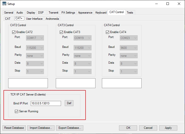

w9mdb wrote:I don't see any TCP CAT control setup in CAT+
Just CAT2 CAT3 CAT4.
it is there.jpg (144.18 KiB) Viewed 12632 times

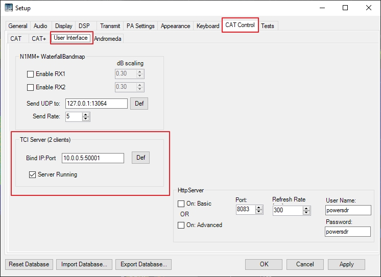

But for TCI for TunerReminder, Log4OM, etc.. you need this:
you need this.jpg (131.35 KiB) Viewed 12631 times
If you run Thetis and Log4OM/TunerReminder on the same machine, please use 127.0.0.1 as ip-address, otherwise, some firewalls may also be in the game.
