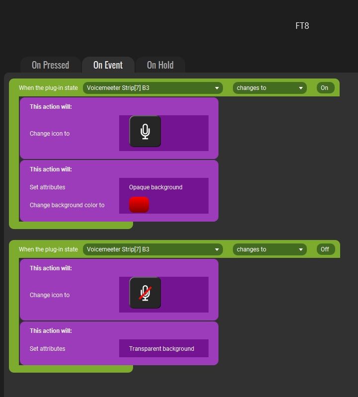

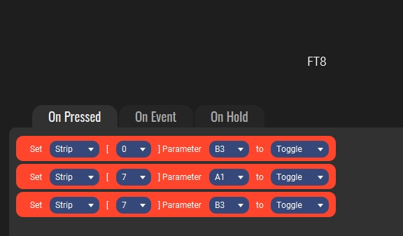

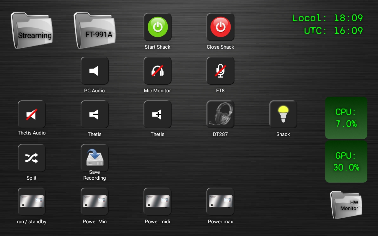

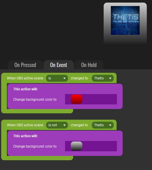

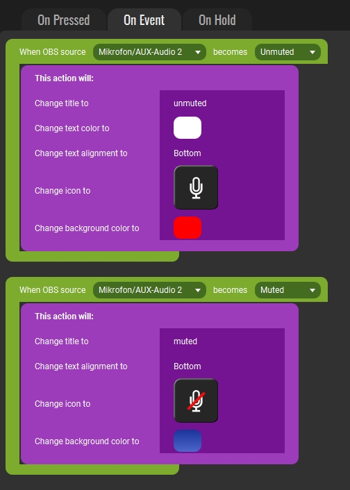

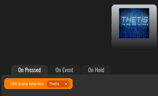

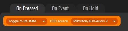

I didn't find a action to send data to COM or ip ports. So this must be done via batch-file or powershell script.
Below some screenshots.
It is very limited.. very very
But since the 13,99 EUR is not a subscription but a lifetime licence, thats absolute ok for me.

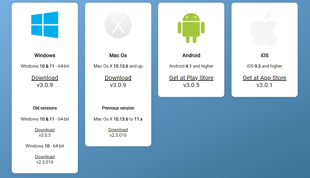

Interesting, i am using the app of streamdeck, and I see that all the .bat files with CAT commands are all usable.
the license is only for a device? ej. only for one tablet or mobile phone ?
Thanks, 73 Jesus
EDIT: mmm I can't see IOS or osx versions...
Thanks, 73 Jesus
