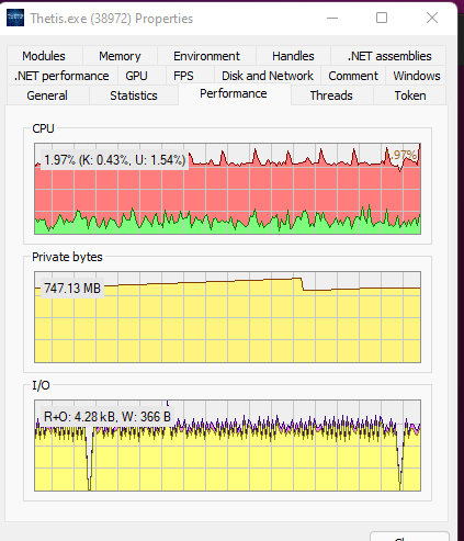

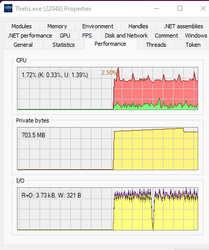

I just did a comparison on my system between 32 and 64-bit with the same database. Not a noticeable difference.
I wonder if you have the same .Net for both 64 and 32-bit installed?
I am doing 48kHz sampling.
Here's my database.xml if you want to test with it
https://www.dropbox.com/s/o0gyr1z9y66a6 ... e.xml?dl=0
32-bit
64-bit
