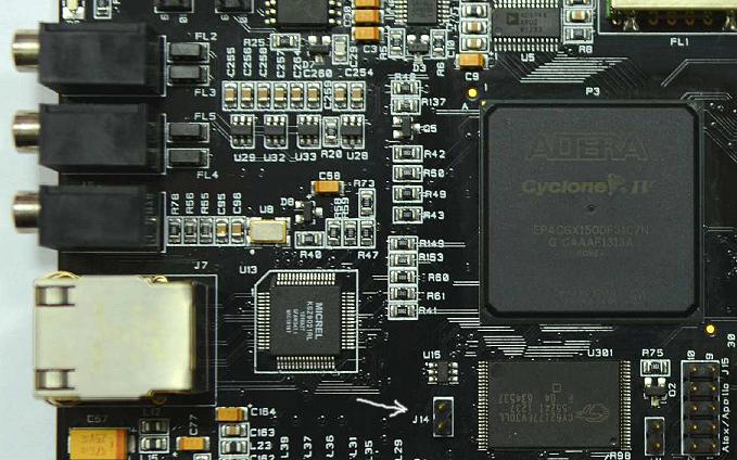

I have had several 200D users mention to me that the little bootloader/run switch soldered to the bottom of the Orion board and accessible through a hole in the bottom plate is very fragile. Apparently, if you slip with whatever tool you insert into the port to slide the mini switch it's very easy to rip the switch right off the board. When this happens, the traces on the bottom of the Orion board can be torn away making it difficult for an end user to repair the damage.

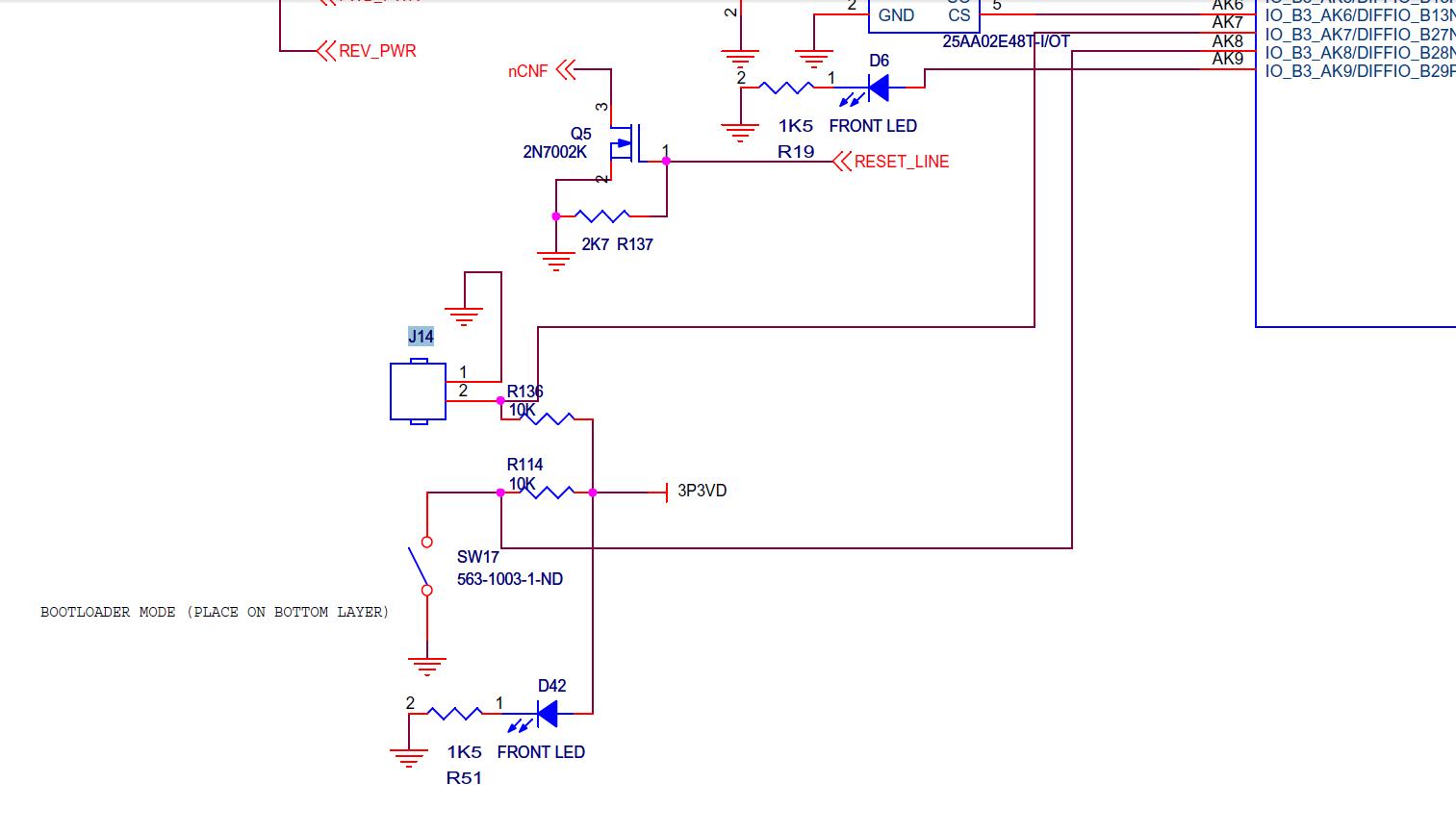

Looking at a photo of the top of the Orion board the J14 jumper block looks like it is right over the mini-switch. I thought it might be parallel to the mini-switch which would be great because you could easily put a jumper onto it to go into bootloader mode, or even better, use a header connector and run the leads to the back panel where a toggle switch could be mounted. Unfortunately, the schematic reveals that J14 grounds pin AK7 of the FPGA and the bootloader/run switch grounds pin AK8 of the FPGA. So, we can conclude that grounding AK8 switches the FPGA into bootloader mode but can anyone confirm what grounding AK7 does?

J14 isn't being used in the Orion1 / 200D firmware as far as I tell.
It's assigned a signal name "MODE2" but nothing is attached to it.
In the Orion2 (7/8000) it's used to tell the firmware that there is an
EPCQ128A -vs- EPCS128 on board.
-Rick / N1GP
