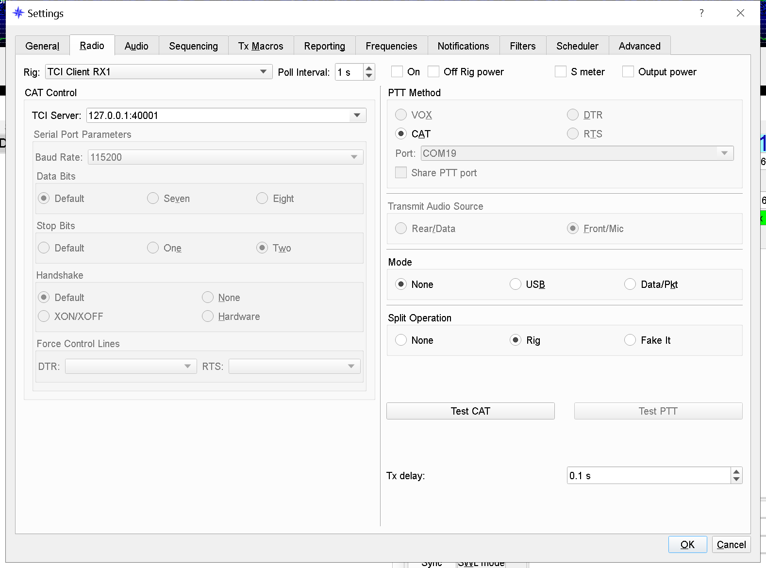

What settings do you have? And you are running JTDX-160-rc1?
Screenshot 2022-04-07 081756.png (34.61 KiB) Viewed 17747 times

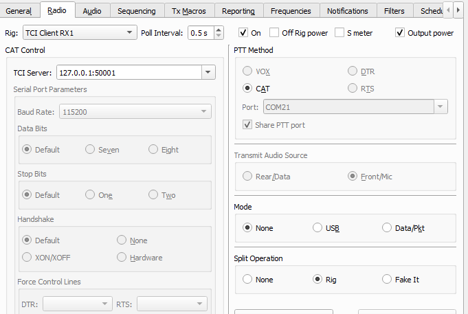

Re: TCI & F/H mode in JTDX not working.
Mike using JTDX 160 rc1. Only difference I see from yours is poll interval , is that critical?

Poll interval shouldn't matter -- I was running 1 second and just turned it down to .5 sec due to another application I'm running that need JTDX to respond quicker on an external frequency change.
You could try 0.5s but I doubt it will help.
My computer is pretty beefy. 3.4Ghz 16 cores doing around 5% usage with everything running.
