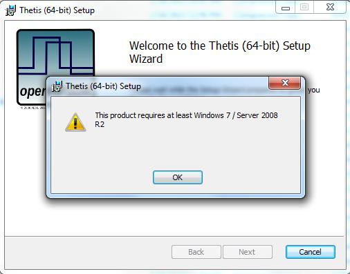

Re: Thetis 2.9.0 Released!
The installer is choking on my Windows 7 installation. Any thoughts on a workaround for this?
Rob W1AEX
hmm I have not used wix installer at all, but a quick scan of the xml in the project, and it seems like it requires a windows version number >= 603, which is windows 8.1. I think it should be 601, but Doug is the man for this.
also seems like WindowsFirewallHelper.dll has been missed from the installer
I have rebuilt the installers to check for >=601, included the missing dll and tested them on a win7 machine, seem ok. Doug will have to change the tapr distro.
https://github.com/ramdor/OpenHPSDR-The ... g/v2.9.0.1
Thank you! The installer ran perfectly and handled the database compatibility update without any issues. Thetis then came up fine with all my settings intact when it was re-started. When I ran the Firewall Check it completed successfully and indicated my firewall was configured correctly.

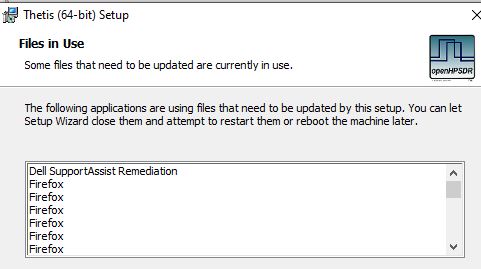

Files in use?
If I run the installer from Thetis-v2.9.0.1.x64.msi, Setup (see attachment) tells me that it wants to update files that are used by:
- Dell Support Assistant Remediation
- Firefox
- NVIDIA LocalSystem Container
What files are overwritten here and can this cause problems? I don't remember the same for Thetis 2.8.11. Is it safe to continue?
András
- Firefox
András

Re: Files in use?
Hi András,HB9LFQ wrote:Hi all,
- Firefox
András
I've got the same message on screen and I stopped firefox for installing Thetis. Up to now I have no problems on my ANAN-PC and I hope it will persist.
Josef
