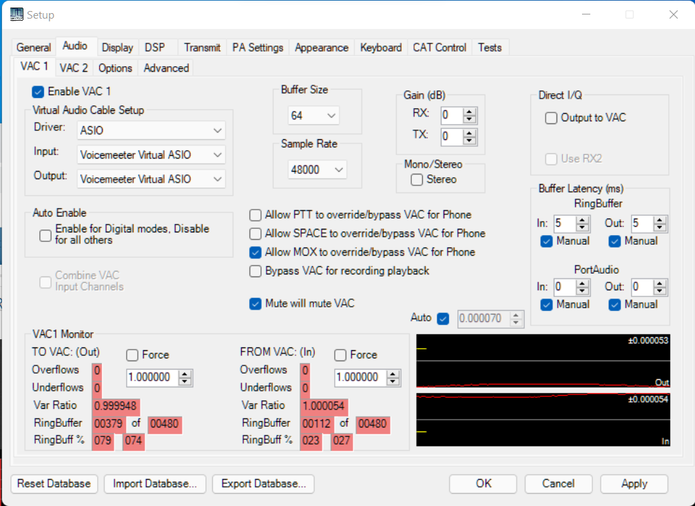

In VAC1, which Voicemeeter Input & Output Audio Device do you select?

W4WMT wrote:Hi Mark,
Bryan
Hi Bryan,
Here's my VAC1 screen:
Audio VAC1.PNG (272.75 KiB) Viewed 9999 times
