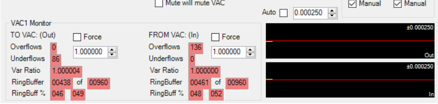

Not an issue, just a minor annoyance since the indicator for overflow/underflow is now shown under the VAC button.
I have tried a whole slew of settings for VAC and have this issue no matter what. Whenever Thetis is started I get a very brief burst of o/f and u/f on VAC (and subsequent GUI indicator) but after the 1/2 second startup burst my VAC is super stable.
I am using a Focusright Scarlett Solo and ASIO.
Thetis 2.9.0 and initial VAC overflow/underflows

does it not fade away? it should fade away until another over/under flow occurs
The setting for this is in audio-options i think. With it checked the warning symbol thing will stay there unless you click it away
could be a bug if that option is unchecked and it is not fading away
Re: Thetis 2.9.0 and initial VAC overflow/underflows
Ah very good Richie, I had it checked (Click to Clear) and unchecking it fades it away.
