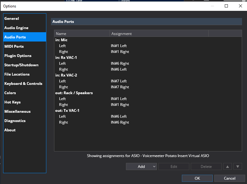

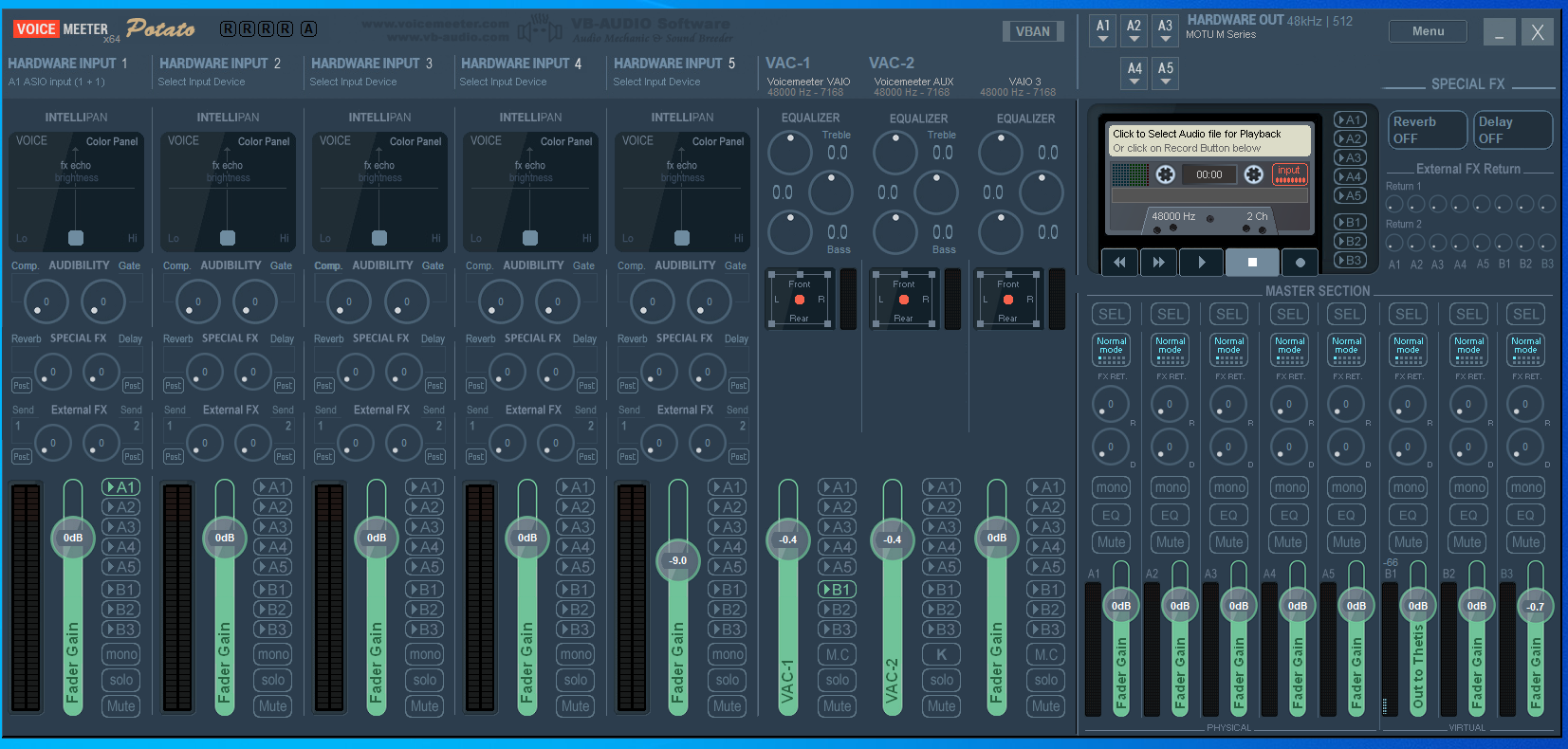

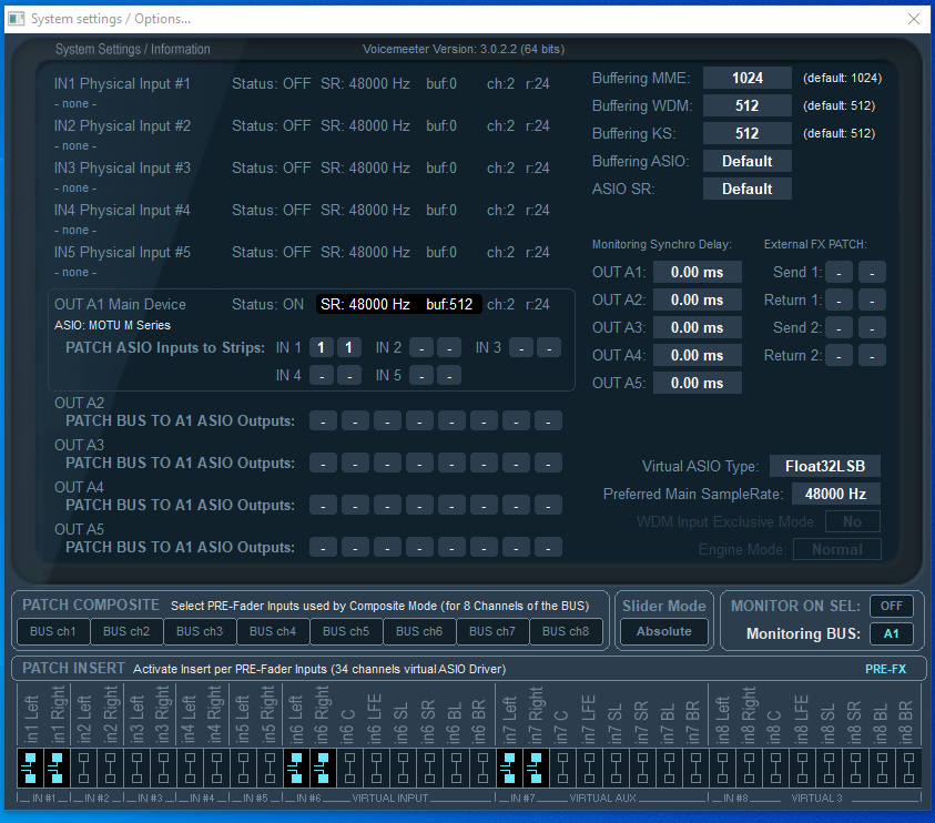

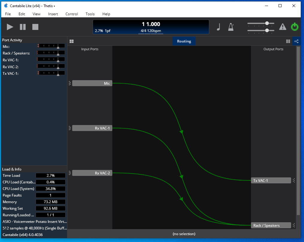

These snips should pretty much describe my setup. And all of this is working perfectly for both Rx on VAC 1 and 2. And Tx on VAC 1.
I am using the Voicemeeter Potato Insert Virtual ASIO driver to connect to Cantabile.
The only thing I can't to is play recorded audio from the "Tape Recorder" in Voicemeeter Potato and send it to Cantabile.

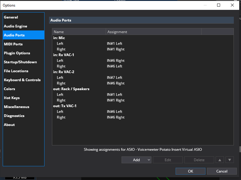

Noticed I had an incorrect port assignment in Cantabile for VAC-2.
Cantabile ports setup.PNG (25.01 KiB) Viewed 9141 times

Nice job on the setup, per your excellent screen shots. Nothing to add there except left and right are reversed on VAC1.
Recording is possible, as I discussed above. Unfortunately I do not think playback is possible into Cantabile, or any DAW, at this time. A quick Google search shows a number of feature requests to VB Audio for patch inserts on the output buses, which is what I believe is necessary to enable this.
I get around this problem by recording and playing back in Reaper. I believe that you can do the same thing in Cantabile.
