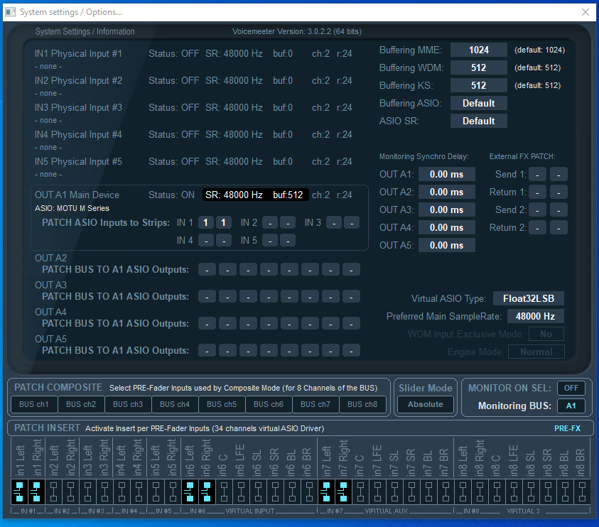

Please post screen shots of the entire main Voicemeeter UI, and of the Voicemeeter System settings/Options window, and also provide any other information with respect to what hardware or software is assigned to each mixer channel, hardware and virtual in Voicemeeter.
I use Voicemeeter Potato with Reaper DAW. This setup should be similar to what you have, and both should rely on the Voicemeeter Insert ASIO driver, and for patch inserts to be activated. I have found that with patch inserts activated on the channel I want to record I cannot record using the pre-fader input selections in Tape Recorder Options. I have to select a post-fader bus output, and make sure my levels are near 0dB of course.

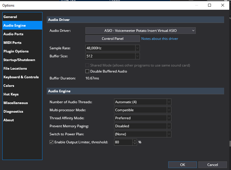

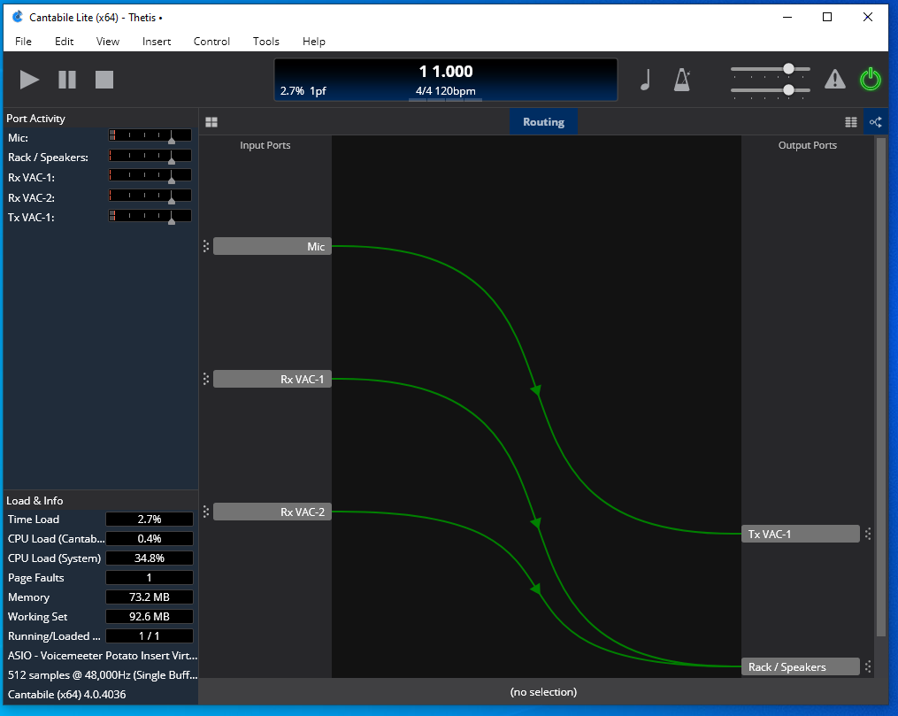

These snips should pretty much describe my setup. And all of this is working perfectly for both Rx on VAC 1 and 2. And Tx on VAC 1.
I am using the Voicemeeter Potato Insert Virtual ASIO driver to connect to Cantabile.
The only thing I can't to is play recorded audio from the "Tape Recorder" in Voicemeeter Potato and send it to Cantabile.
cantabile routing.PNG (98.38 KiB) Viewed 9149 times
Cantabile ports setup.PNG (26.27 KiB) Viewed 9149 times
cantabile driver.PNG (29.38 KiB) Viewed 9149 times

KC4MNE wrote:The only thing I can't to is play recorded audio from the "Tape Recorder" in Voicemeeter Potato and send it to Cantabile.
Nice job on the setup, per your excellent screen shots. Nothing to add there except left and right are reversed on VAC1.
Recording is possible, as I discussed above. Unfortunately I do not think playback is possible into Cantabile, or any DAW, at this time. A quick Google search shows a number of feature requests to VB Audio for patch inserts on the output buses, which is what I believe is necessary to enable this.
