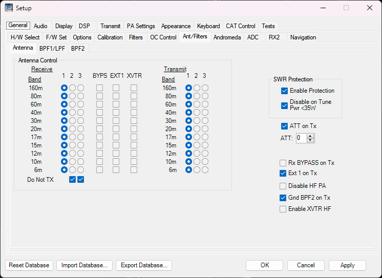

I recently moved to a new home (new to me). I've been trudging through getting things reconnected and tuned. Today I connected and tuned the AL-80B amplifier. On the output of the amp I have an RF sampler that I was previously using without issue. The brand is CleanRF. I have the output of the sampler connected to EXT1on the rear of the transceiver. At the SETUP>GENERAL>ANT/FILTERS location I have "EXT 1 on Tx" selected. The issue is I am not seeing any feedback from the sampler to EXT1 when I transmit. in this state. Here are my settings on this page.
Without "EXT 1 on Tx" selected, PureSignal works perfectly with the feedback in the transceiver.
With "Ext 1 on Tx" selected and using the amp, I do see a slight bit of feedback. The feedback indicator is Blue with a signal level of 29. Even with no wire connection from the sampler to EXT1 I'm seeing a level of 29. I tried a different cable with the same result. I tested both cables and no problems were found.

The internal RF signal paths on the 7000 do not support EXT for external PureSignal feedback from a coupler. You have to use the Bypass input and select the option for Bypass on TX.

Right you were again and it works perfectly. I don't know what I was thinking with my original post. :o :lol:
