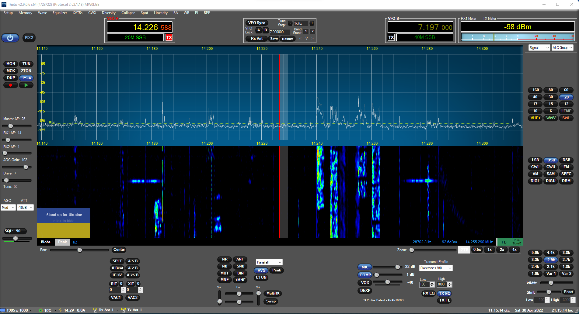

1. Installed Thetis 2.9.06 on my PC and Notebook, in both cases the "Tune Power" slider is missing.
Displayed setting is stuck on 50.
Refer to screen shot

3. Spectrum Display shows ghosting, also seen in the attachment.

AndrewK wrote:1. Installed Thetis 2.9.06 on my PC and Notebook, in both cases the "Tune Power" slider is missing.
Any time a new button or slider is added you need to update your skins.
Sigi has created a wonderful tool to make this task much easier:
https://apache-labs.com/community/viewt ... f=9&t=4166
Remember that skin updates generally lag new software versions, so sometimes you may need to wait a few days for skins to follow along.
2. CPU Usage, only have System option, Thetis not available.
The Thetis option was disabled because it was causing a memory leak. The memory leak is due to an intractable (so far) bug and was thus put on the back burner.
It's not ghosting, it's the panadapter Active Peak Hold ("Peak") display feature. This has been in the software for a good many revisions now. Enable/disable it with the Peak button or in Setup > Display > RX1.
I know it can seem daunting, but it's worth reviewing Richie's always extensive release notes to see what's new, modiifed, or fixed in each version:
https://github.com/ramdor/Thetis-2.9.0/releases

The Tune Slider is there and functioning now on the PC. Will have to revisit the Notebook as I did download new skins on to it just a couple of days ago and still had the problem.

Powered up the Notebook today and the Slider was there.
