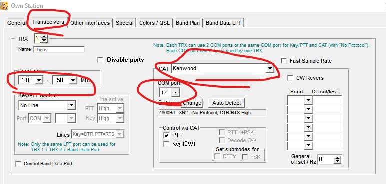

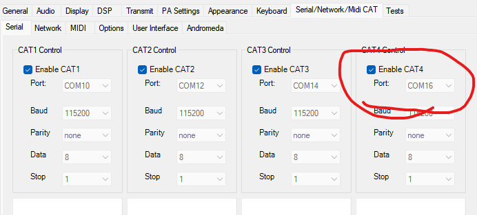

Thetis -- must add virtual serial port software. Eltima is recommended. In this example COM16/17 is a virtual serial port pair.
UCXLog
- Screenshot 2022-05-17 085730.png (44.39 KiB) Viewed 15908 times

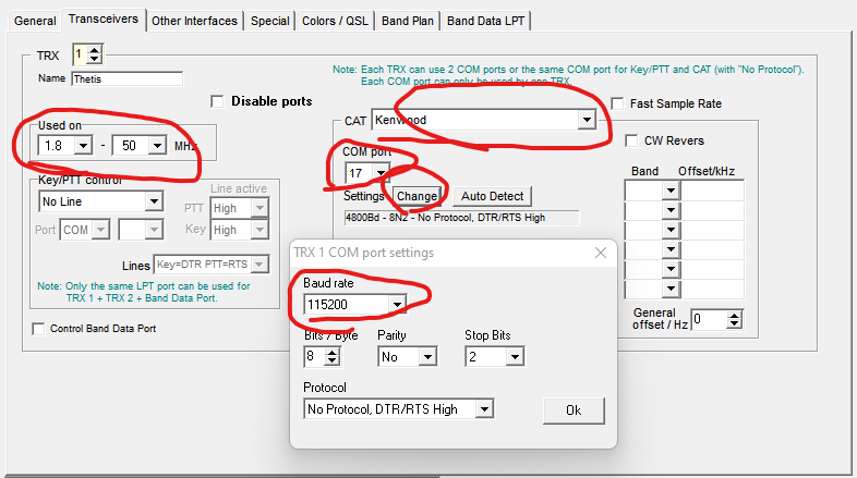

OK, thank you very much for info,w9mdb wrote:Thetis -- must add virtual serial port software. Eltima is recommended. In this example COM16/17 is a virtual serial port pair.
UCXLog

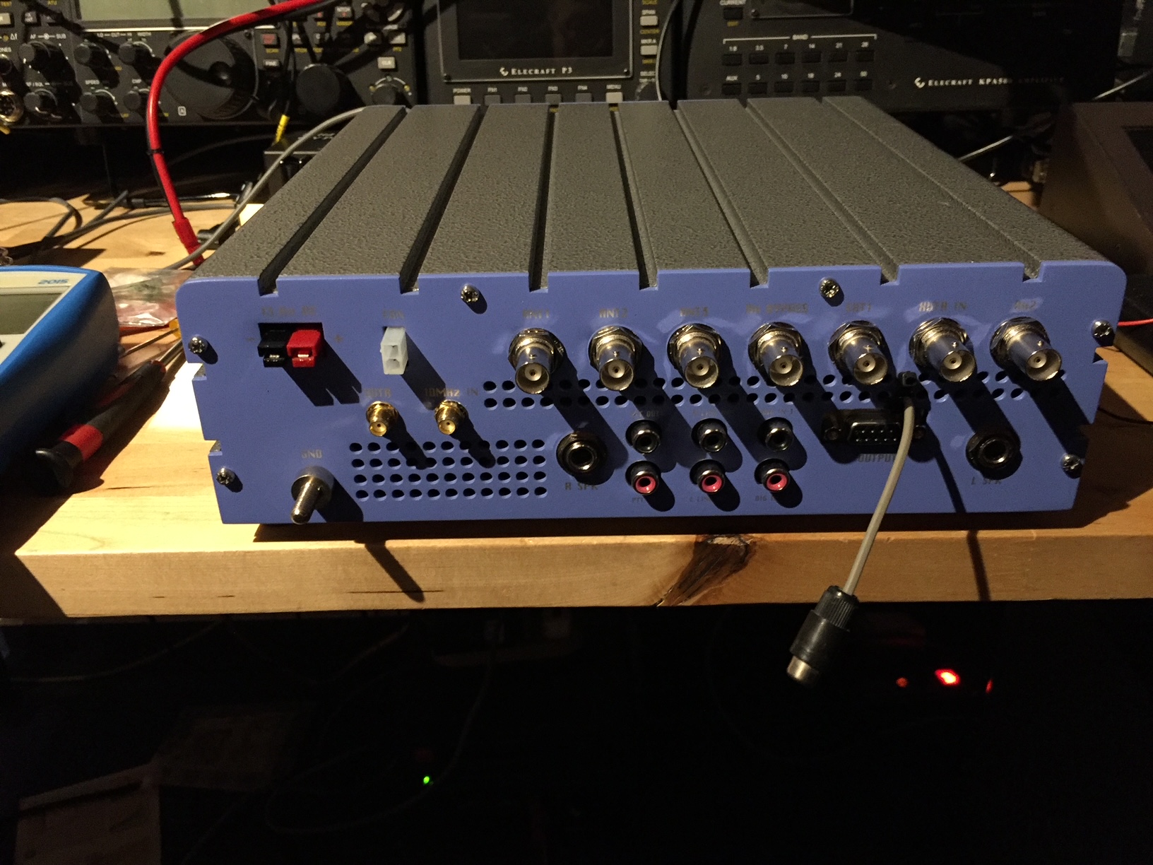

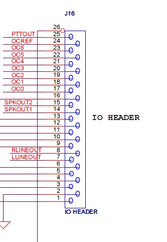

If you read what Volker wrote, and have looked at the connectors available on the front and back of the 7000, you will clearly see that that cable will not work without modification.4L5O wrote:Ok, thank you for information, i hope this cable is for ANAN 7000 Will be ok, https://www.microham.com/Downloads/DB37-FX-5000.pdf
The 7000 does not have Line Out connection available. That signal does exist inside the unit but the unit would have to be internally modified to bring it out. This is an easy modification for folks who can read a schematic and use a soldering iron. Note also that it is not a true line out, the audio gain varies with the volume settings.
The 7000 key input is a 3.5mm TRS jack. There would need to be an adapter between the 6.3mm plug and that jack. Buying an adapter or an adapter cable should be easy.

1 cable 2m long stereo (shielded) to DB9 female for CAT (PC) just like in the drawing!
Do not forget the jumper contacts.
The only difficult thing is to connect the shields of the 3 analog lines to the pins ISOLATED FROM EACH OTHER.
A standard Cinch Mono Cable should be used to connect „PTT Out“ from the ANAN to the „PTT In“ of the MicroHam.
Volker
DL4ZBG
I have ordered and have not yet received Annan 7000 dle, I wonder if you have a photo remake line Out, I have even seen the photo but I do not know exactly if it is.
thanks.
With best wishes, 73!
- LO.jpg (1.05 MiB) Viewed 15518 times

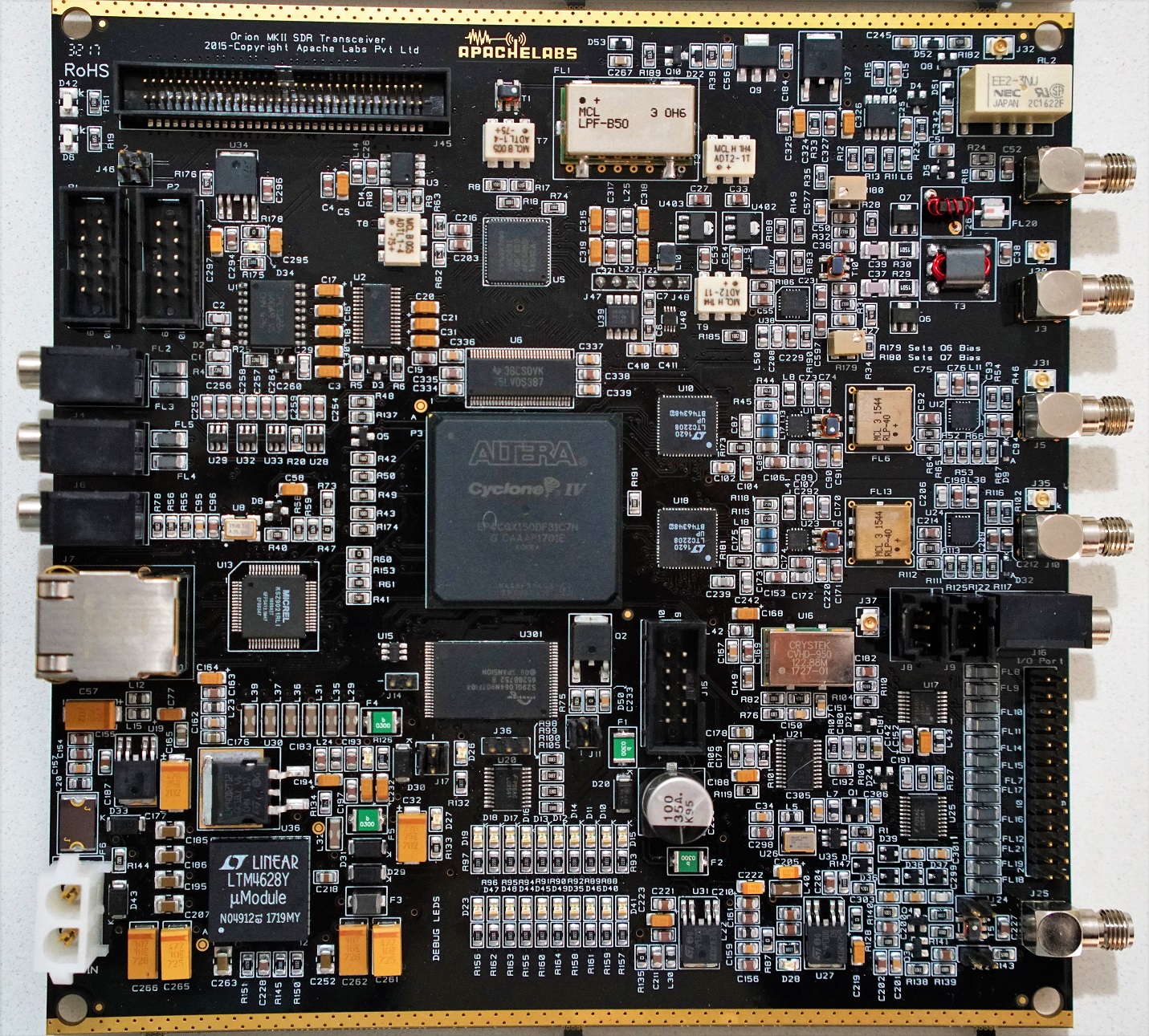

I recommend you leave the Orion MKII board alone and instead cut and jumper the so-called rear panel "spreadout board" (what most would call a breakout board), which is the board that holds the six phono, two speaker and one DE9 connectors on the rear panel.
That board has a header connector marked J2 on it. It is connected to its corresponding connector J16 on the Orion MKII board. Here is a schematic snippet of the header connector on the Orion:
Pin 7 is left channel line out. You might do something like cut/jumper that to the Right Channel Line-in phono jack, just to make things neat and clean. Or, alternately, use the DIG 2 phono jack. Or you could add another connector somehow.
Apache continues to ask that the Orion MKII schematic, and the other board schematics of the 7000, not be publicly posted. However they will provide them privately upon request. In the mean time, where J16 is concerned it, its associated circuitry, including all OC, PTT and audio related IO, has remained essentially identical across all models from the original ANAN-10 through the ANAN-7000. If you download the schematic for the Orion board in the ANAN-200D (available in the schematic section of this forum), you will know the entire pinout for J16 and thus J2 on the ANAN-7000 spreadout board.

Ok, many thanks for info,w-u-2-o wrote:I recommend you leave the Orion MKII board alone and instead cut and jumper the so-called rear panel "spreadout board" (what most would call a breakout board), which is the board that holds the six phono, two speaker and one DE9 connectors on the rear panel.
i will try to find schematic,
kind regards,

I soldered a shielded cable directly to pin 7 (Line Out Left ) and 2 (GND) of the I/O board. I noticed some RFI (hum) due to ground loop effects. The use of an AF transformer may help.
Volker
