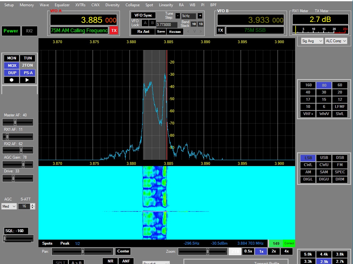

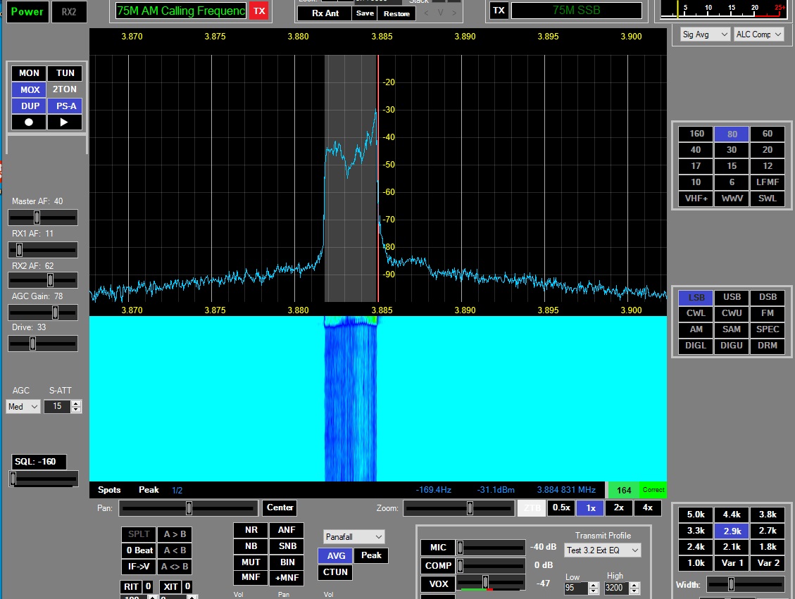

Might be something to his concern with 2.9.06. I've noticed a "flair up" in the broadband noise sometimes with voice input.
See screen shots. Both are with voice input into 50 ohm load using AL80B amp at 800 W with coupler feedback to my Anan 7000.
When the noise comes up, I see the lower right Pure Signal indicator at a different number and 1 dB difference in the Attn setting.
Never saw this before with version 2.8.11 MW0GE 21i Protocol 1. Spectrum will be good, then slowly grow up to the wide noise level. If I keep transmitting, it seems to slowly fix itself.
This doesn't happen all the time at every transmission and all cables are tight and nothing changed except going to 2.9.06.
It looks like feedback level is changing, although my peak power output is the same, as far as I can see.
Not the end of the world since spectrum is still much better than most radios on the air but it is different than earlier version.
- Noise flair with PS.jpg (229.27 KiB) Viewed 6113 times
- Normal PS Spectrum.jpg (220.1 KiB) Viewed 6113 times
Re: pure signal not working right 2.9.06
I've seen that behavior on every version of PureSignal since my first ANAN that I got back in 2014.
There are clearly no major, intentional changes in 2.9.0.x versions as compared to 2.8.11. Could there be subtle, unintended issues? Certainly.
The the key word is "subtle". If there were major differences the forum would be lit up like a Christmas tree with observations and complaints. But it is not. Nor are any of the other, much smaller, on-line discussion groups (I checked).
Certainly your changes are subtle. If you are satisfied with the IMD performance of your signal within a couple of KHz then beyond that it just keeps getting better, even with the "flare up". Nobody will notice anything.
By far the thing that most drives PureSignal stability is consistently reaching 0dB (or higher) ALC levels. Just moving away from the microphone a few inches can have a dramatic effect, depending on how the audio processing is configured.
It's always worth reevaluating PureSignal related setup from time to time. Things do change. Operating habits, tube performance, minor changes in audio setup. Antenna impedance is a big one, changes there can affect amp linearity. And software, of course.
One way to determine where changes might be necessary is to use the two-tone test signal. Since two-tone bypasses all audio processing and is designed to hit 0dB ALC perfectly, if you use two-tone and see problems then the changes that are necessary are most likely going to be found in the Linearity > Advanced menu.
If all is perfect and stable with two-tone, then it might be time to look at audio setup. For instance, I always run with levels sufficient to see about +3dB ALC on peaks. Since ALC is a soft, look-ahead limiter, this just adds a tiny bit of additional compression while ensuring that there are frequent and solid enough voice peaks to get frequent, high quality PureSignal corrections.
Using the AmpView display is also an excellent way to monitor the performance of the feedback signal. Dashed, dotted, or badly distorted curves are an indication that the feedback data is bad. This could be due to many factors, but at least it will get you looking.
Finally, even if it is a small change in the software, and I'm not saying it is, perhaps then for some people it may require a small change in settings to recover back to the behavior seen in the previous software version. Given how the software (and firmware) are developed, that seems like a small price to pay to gain the new features and fixes in the latest version. We are all using the Ferrari of radios. With 40+ setup screens and who knows how many lines of code it's not wrong to characterize it as some high strung stuff. It definitely requires periodic tweaking to maintain maximum performance.
