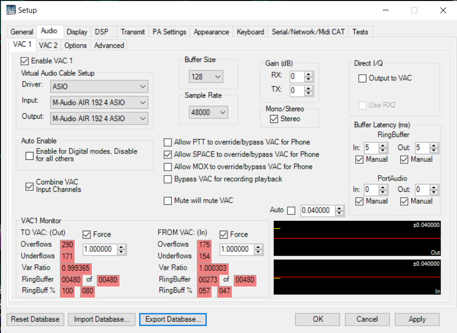

Not sure why, but out of the blue I am seeing very large under/overflows occurring although I haven't changed anything?
Running Thetis v.2.9.06 x64 (Protocol 2, v.2.1.18). PC: Windows 10 (not Pro), CPU: multi-core i7, 32GB RAM, 512 GB SSD NvMe.
See a couple of screen-shots immediately below. I can send shots from other forms if that helps.
Update: Several thousands now for both Under/Overflows (after about 10 minutes).

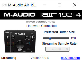

Appreciate your suggestions, but M Audio does have a control panel (see below) that shows a 128 buffer size and 48k sampling frequency just like it is on the VAC1 form.
I have used M Audio for many months straight. After upgrading to Protocol 2 I am starting to see this phenomenon and I have been on Protocol 2 now for a few weeks if my memory serves. Come to think of it, I am not sure that I have really checked what is happening on the VAC1 form, but only I have seen a few "flickers" of little red squares (and some green) just under "VAC1" on the main GUI.

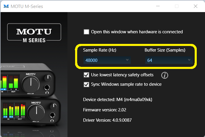

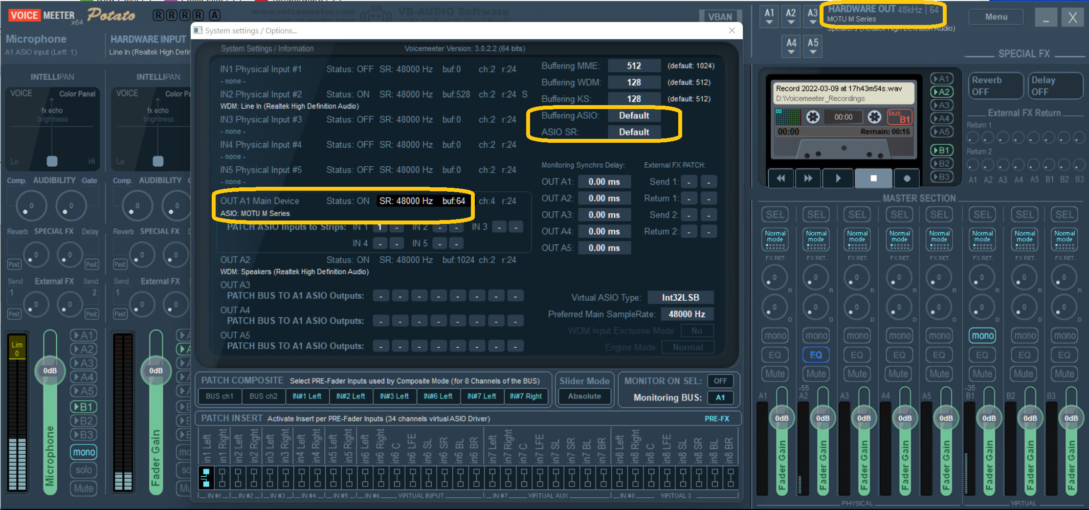

That's not what I'm seeing...here are some snapshots of VM correctly picking up and syncing with my ASIO settings:W4WMT wrote:Purely for the benefit of someone searching this topic in the future: I recently did a deep-dive in the PortAudio source on this very question. PA tries to negotiate a buffer size from the loaded ASIO driver that matches the buffer size selected in Thetis' VAC1(2) drop box. If that fails, it uses whatever buffer size the ASIO device is already set for, and then inserts an extra ring-buffer between Thetis and the ASIO device to adapt between the two buffer sizes (Thetis' and ASIO's). A good example of this is the VoiceMeeter virtual ASIO driver, which will not negotiate through the usual ASIO API, and will only use the buffer size its user has set.
Re: Very large Under/Overflows all of a sudden
I was talking about the buffer size shared between Thetis and VM.
Oh, thanks, I misunderstood.W4WMT wrote:I was talking about the buffer size shared between Thetis and VM.
