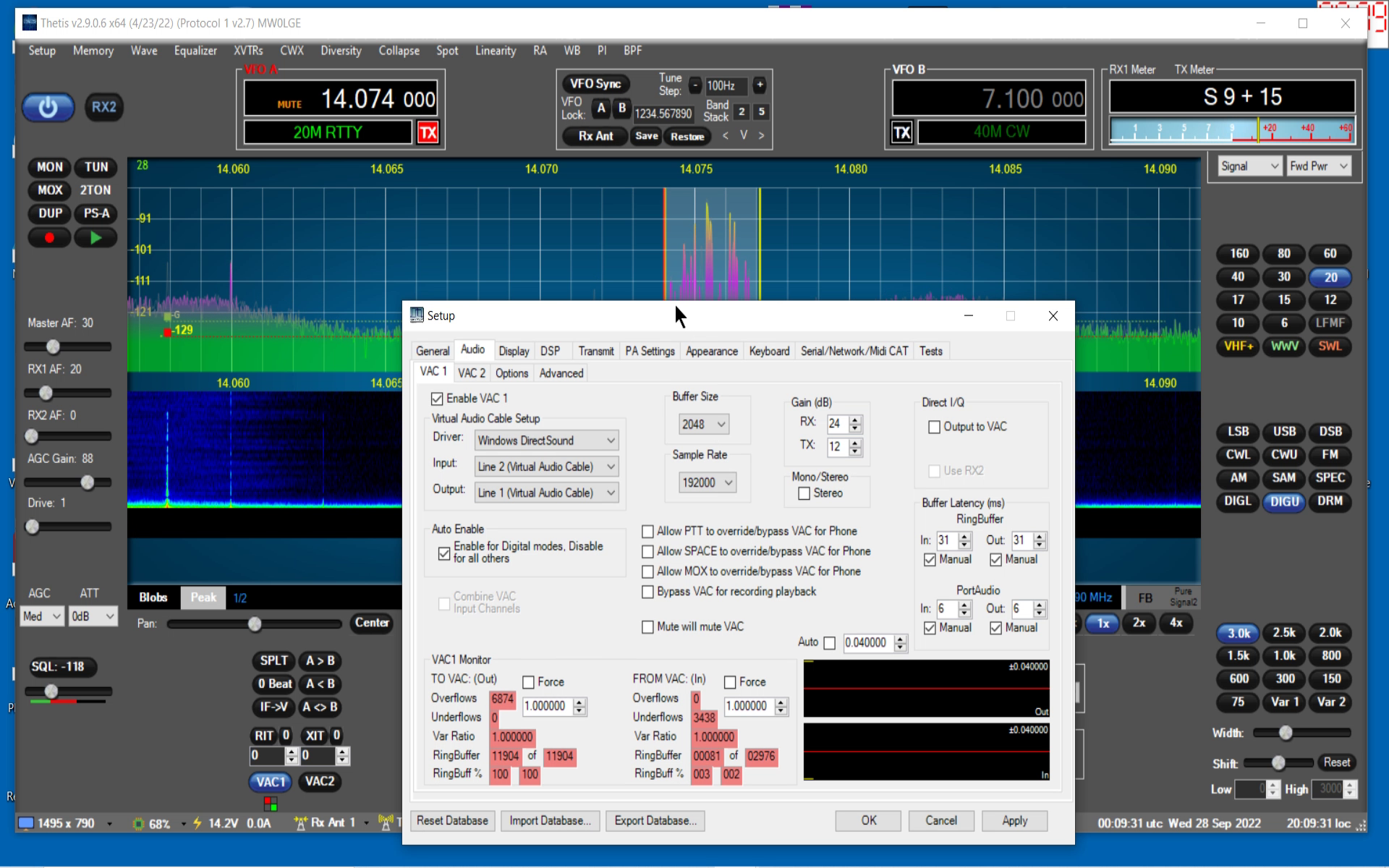

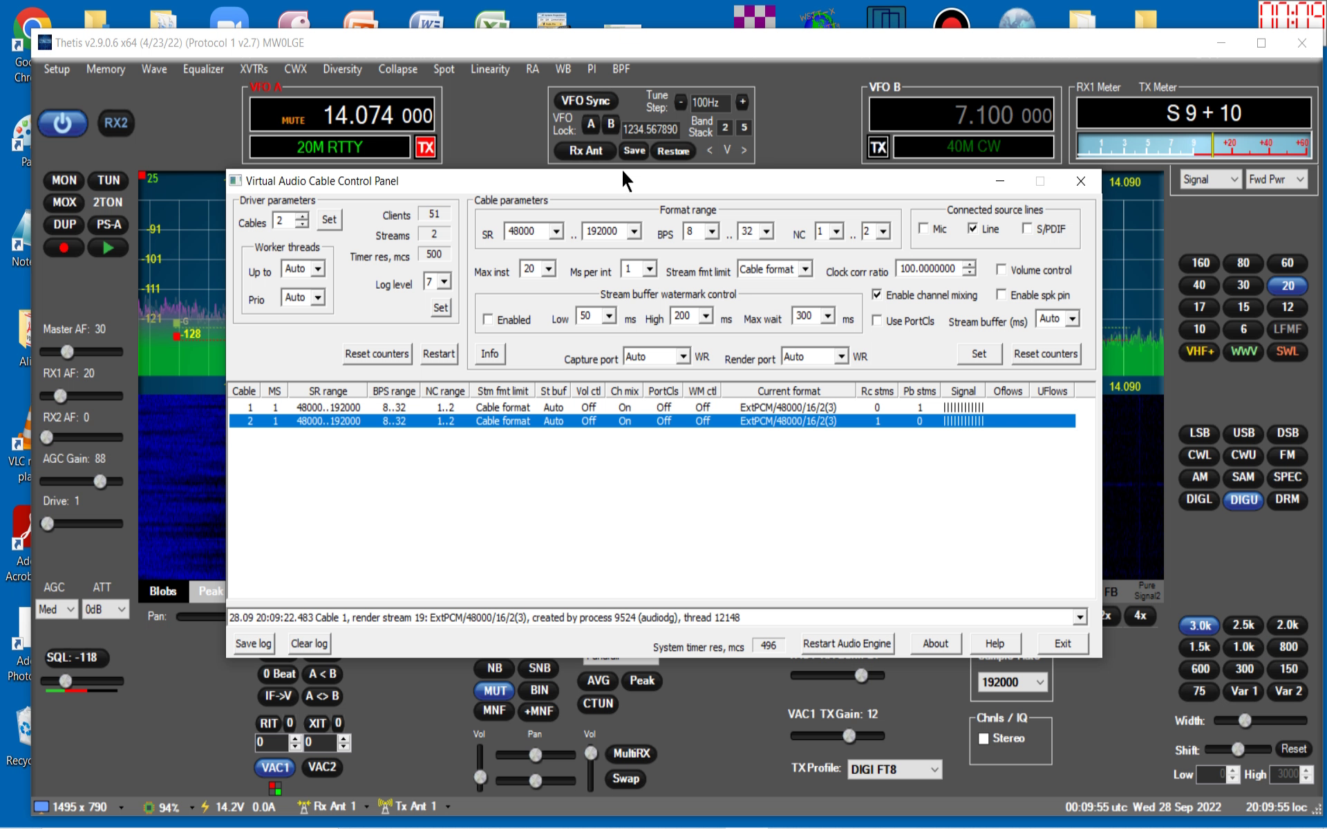

Please post screen shots of your Muzy VAC control panel and the Thetis VAC1 setup screen.

The screen shots you asked for:
Posts: 6081
Re: No audio on VAC with Thetis 2.9.0.6
I forgot to ask you for a screen shot of the setup screen for WSJT-X. Please post that as well so that we can check proper assignment of Cables 1 and 2 vs TX and RX.
Do not use DirectSound. Use MME.
Change your sample rate to 48KHz.
Enable the Stereo checkbox.
Change your RX and TX gain to 0dB. It is RARELY necessary to need any other setting. Settings other than 0dB are indicative of other setup problems. Adjust your drive properly in WSJT-X, use DIGU in Thetis, set RX1 AF to 100 in Thetis, you should NOT need to change VAC gain from 0dB for WSJT-X.
It would appear you copied your Buffer and PortAudio settings over from PowerSDR. They will be different in Thetis. For now change these all to automatic.
When you get all this done, and if Cables 1 and 2 are not reversed, VAC should be working with WSJT-X and under/overflow counts should be low or zero. You can zero those counters by clicking on them.

I applied all of your suggested fixes and it now WORKS.
Not sure which one did the trick but I am getting audio to WSJTX for sure. All is as it should be.
