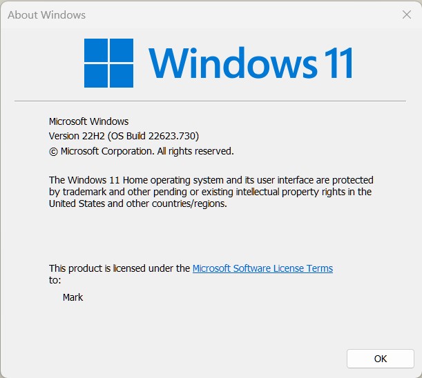

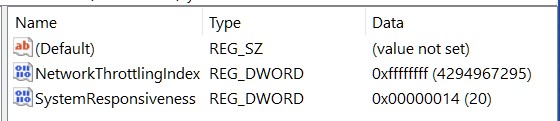

I'm on W11 22H2 Insider Preview Build 22623.730 and my setting hasn't changed:
