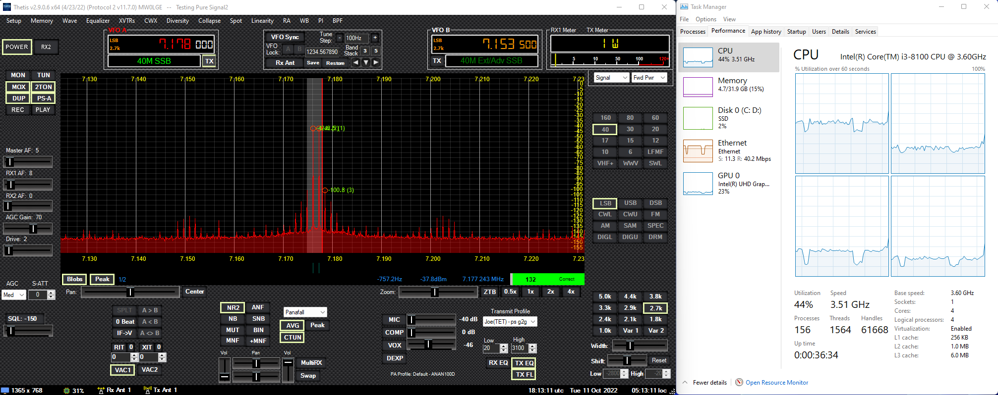

The other interesting observation is the actual PS2 performance with the 2-tone test with respect to output power.
Here is a table of results – frequency used was 40M band 7.178Mhz – Observation was using 3rd Harmonic in relation to 1st Harmonic – RF Power used was 1W, 20W and 100W – to get a trend.
RF Power: 1W, 20W, 100W
Suppression: 31.8 dbm , 12.8 dbm, 23 dbm
Network Load increase when PS2 ON: 19.1Mbps, 19Mbps, 19.6Mbps
We can conclude the following; -
When PS2 is active there will be at least a 20Mbps increase (this was consistent within measurement errors) in network bandwidth – make sure your system(s) can handle this with sufficient headroom.
There is a “sweet spot” with PS2 – this is expected (and the limited sample results confirm this) – as each radio is different – in particular with the RF amplifier semiconductor nonlinearities (within the Anan finals as was in my case as no external Amp was used).
In my case there is a much better PS2 “efficiency result” with very low power – and again more efficient with higher power than in the 20W range (again my specific radio and limited results).
Below is a screen grab of one of the tests (1W – low power) with PS2 “on”
on 1w ps2+cpu.png (421.93 KiB) Viewed 6820 times
Hope someone finds this information useful ;)
I certainly learned a lot by just doing these basic tests with a dummy load - most notable aspect being the "heavy traffic" on the network between the PC running Thetis and the Anan - when PS2 is active - confirming that all the heavy lifting with PS2 is done on the PC running Thetis.
You can now clearly see why the current Anan setup is not suitable for Remote operation via internet.
It will fail - because you will need a "solid" conection with at least 25Mbps continous no loss in packets AND at least 50Mbps when PS2 is running.
Unless you have extream internet speeds and can guarantee low latency (ping times) without packet loss - its highly unlikely that you will have trouble free operation whilst attempting to use the Anan remotely via an internet connection. :)

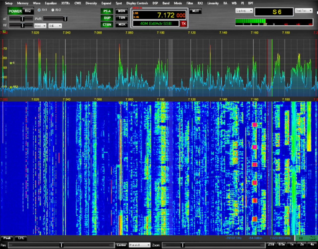

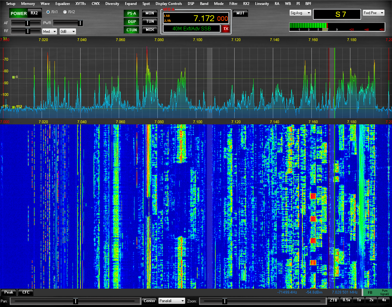

Against better knowlage i had a try on video codec.
This is not what i want to look at!
Even at 25mbit/s (4 times the IQ-stream) the quality is not acceptable.
(Please explore the screenshots at 100% resolution)
Correction
That was a scaling problem. The capture app had scaled 1280x1024 to 720p and the decoder had scaled back to 1280x1024. :oops:
So it is possible to code and decode pixel exact, but at 60fps there is a massive CPU load on the source computer (hardware accelerated codec used) that leads to slow down thetis degrading framerate and provoking audio stutter.
