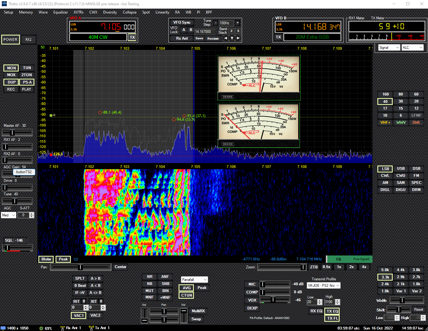

Just posting some feedback for Richie on the Thetis 2.9.0.7 (Protocol 2 v11.7.0) MW0LGE pre-release
This is my first Thetis compile – all good (100%) – I put a “Joe Testing” tag in the titles – so I can keep track of my test compiles.
I can report all is working – the meters really look good – great work Richie - and fantastic graphics from OE3IDE thank You for your contribution(s).
first compile with new meters work-in-progress-2.png (914.97 KiB) Viewed 32487 times
One thing I noticed is that my CPU% went up significantly
with the official release (2.9.0.6 (4/23/22)) was 20% CPU
with this testing pre-release - (2.9.0.7 (4/23/22)) was over 60% CPU
- a significant increase
– not sure if this is because of the meter’s “code” or something else in the pre-release code or my compile?
Anyway – hope the above information is useful ;)

Joe, how do you keep the Two meters alway open in Receive, I have a blank window, but when I transmit the TX meter appears??
VK-JOE wrote:@Scott - feel free to move this topic if a more appropriate post already exists

N4QNT wrote:Joe, how do you keep the Two meters alway open in Receive, I have a blank window, but when I transmit the TX meter appears??
I did nothing special - did not configure anything - just used the default Meters (directory Richie provided) which is sitting on same level as Skins directory.
I "sized" the meters and dragged them into a non-active (no signals) part of the panadaptor screen display.
Obviously the "meters" are NOT Expanded and have focus INSIDE the active Thetis window. <<<<< THIS IS PROBABLY MOST LIKELY WHY YOURS DISAPPEAR
Some other comments - I "run" my Thetis.EXE (which I compiled) code from the bin>x86>Debug directory because I did not want to "zap" my working Thetis directory with my experimentation compilations and testing code. I also loaded a saved copy of my “working” (2.9.0.6) database.
I still have not fully explored the Meters code - just wanted to let Richie know - that no problem to compile and that "it works" out of the box so to speak.
I noticed that my frame rate (set to 50) normally has absolutely no problem with the "release" version of Thetis (2.9.0.6) - no warning "red dot"
With the pre-release code I compiled (2.9.0.7) - I noticed the same frame rate (still 50) is now exhibiting the "red dot" telling me it can’t maintain the 50 FPS.
I guess this is probably one of the reasons why Thetis is high CPU% now - something to do with the graphics code.
Please Note: I am only using the Intel UHD Graphics 630 which is built -in on the i3-8100 CPU (3.6GHz) which is my system.

I just did some more testing - like TX into dummy load - and noticed that my x-hair meter does not pop-up its blank during TX :roll:
Not sure what's happened here - but something obviously different to BOTH of our configurations :oops:
I tried to re-size and popped them outside the Thetis window - still no x-hair (TX) meter :(

For the cross nedle meter to work, you have to rename the file "cross-needle-100.png" to "cross-needle.png.
Or edit line 1586 in MeterManager.cs to match the filename. Or vice versa.
