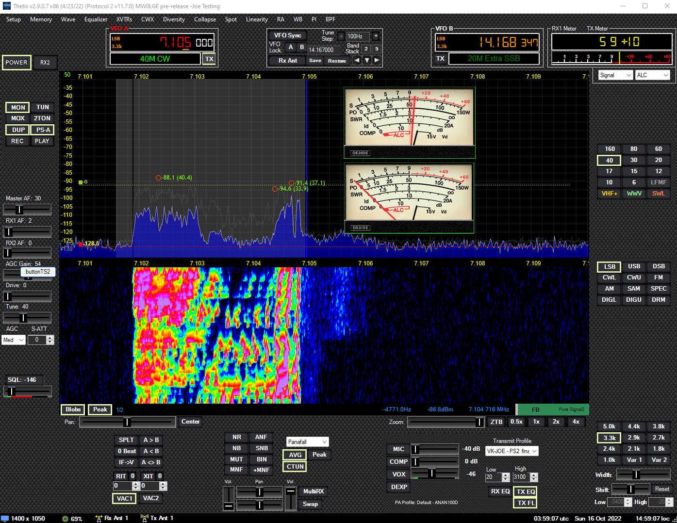

Just posting some feedback for Richie on the Thetis 2.9.0.7 (Protocol 2 v11.7.0) MW0LGE pre-release
This is my first Thetis compile – all good (100%) – I put a “Joe Testing” tag in the titles – so I can keep track of my test compiles.
I can report all is working – the meters really look good – great work Richie - and fantastic graphics from OE3IDE thank You for your contribution(s).
first compile with new meters work-in-progress-2.png (914.97 KiB) Viewed 34031 times
One thing I noticed is that my CPU% went up significantly
with the official release (2.9.0.6 (4/23/22)) was 20% CPU
with this testing pre-release - (2.9.0.7 (4/23/22)) was over 60% CPU
- a significant increase
– not sure if this is because of the meter’s “code” or something else in the pre-release code or my compile?

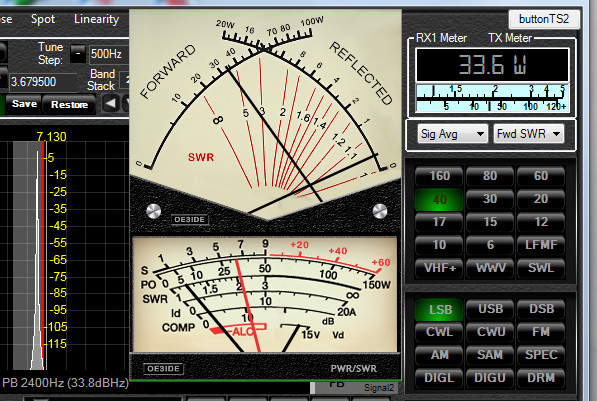

N4QNT wrote:Joe, how do you keep the Two meters alway open in Receive, I have a blank window, but when I transmit the TX meter appears??
I did nothing special - did not configure anything - just used the default Meters (directory Richie provided) which is sitting on same level as Skins directory.
I "sized" the meters and dragged them into a non-active (no signals) part of the panadaptor screen display.
Obviously the "meters" are NOT Expanded and have focus INSIDE the active Thetis window. <<<<< THIS IS PROBABLY MOST LIKELY WHY YOURS DISAPPEAR
Some other comments - I "run" my Thetis.EXE (which I compiled) code from the bin>x86>Debug directory because I did not want to "zap" my working Thetis directory with my experimentation compilations and testing code. I also loaded a saved copy of my “working” (2.9.0.6) database.
I still have not fully explored the Meters code - just wanted to let Richie know - that no problem to compile and that "it works" out of the box so to speak.
I noticed that my frame rate (set to 50) normally has absolutely no problem with the "release" version of Thetis (2.9.0.6) - no warning "red dot"
With the pre-release code I compiled (2.9.0.7) - I noticed the same frame rate (still 50) is now exhibiting the "red dot" telling me it can’t maintain the 50 FPS.
I guess this is probably one of the reasons why Thetis is high CPU% now - something to do with the graphics code.
Please Note: I am only using the Intel UHD Graphics 630 which is built -in on the i3-8100 CPU (3.6GHz) which is my system.
Your comment about no PS glitches and SEQ errors ... I can confirm that they are directly correlated to the quality and BW of your network connection with the PC and Anan radio.
As I was stressing my network on the PC - approaching 100Mbps - while Thetis was running - I could see some SEQ errors popping up - just a few - but they only did this when the network was under stress - otherwise I just don't get any SEQ errors. (I believe others have also confirmed – poor network = SEQ errors)
BTW - My working environment is Windows 11 Pro 21H2
I also noticed you have different HW to me (100D) and obviously the F/W is also different.
At this stage I am not sure if this has any bearing on the Meters "code" / function.
My compile reveals a "button TS2" - I cannot move this - I presumed this is temp code Richie put in to "reset meters" to known location within the window - as this is the current behavior OR my compilation went wrong somwhere - despite no warnings :?:
Hope the above comments are useful ;)

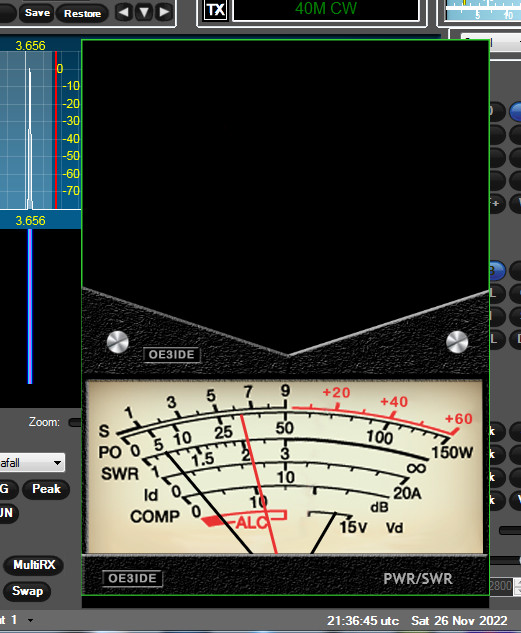

@ N4QNT
I just did some more testing - like TX into dummy load - and noticed that my x-hair meter does not pop-up its blank during TX :roll:
Not sure what's happened here - but something obviously different to BOTH of our configurations :oops:
I tried to re-size and popped them outside the Thetis window - still no x-hair (TX) meter :(

For the cross nedle meter to work, you have to rename the file "cross-needle-100.png" to "cross-needle.png.
Or edit line 1586 in MeterManager.cs to match the filename. Or vice versa.

Hi
What could be?
No multimeter needles in transmit mode.

Thank you, Sigi.
No TX meter here either. Missing image file? Screen capture below shows unknown open black space below S-Meter.

Post by DH1KLM »
Heck, I fell into the same trap I described earlier. :?
viewtopic.php?f=9&t=4365&p=22117#p22117
Sorry for that. ;)
The problem is now gone and hopefully it should work properly now.
A new version is compiled and uploaded.
Both Thetis installer and a zip file with the executable files are available.
https://github.com/DH1KLM/Thetis-2.9.0.x/releases

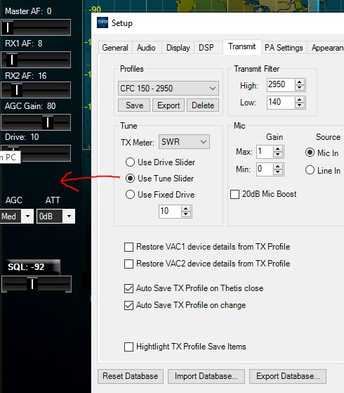

Post by DK1WP »
Although implemented in the skin, I cannot activate the Tune slider with this version.
Is this only the case for me?
