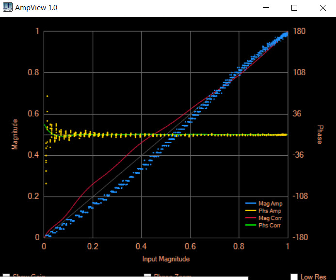

I have DUP on to see my TX out and Feedback PureSignal 2 are both green, but it is clear from the 2-tone that Pure Signal is not working, looking at the "spurs" that are not as much down as they are when this feature is working.
Amp view looks really weird. Never seen this before.
Update: Powered off the radio and now Pure Signal appears to be working although I still see some "fuzziness" on the curves in Ampview, but little compared to just a few minutes ago. And, yes, when I clicked the "Linearity" tab I see the box in green there, saying it is "correcting." Just wondered why PR wasn't correcting before, all of a sudden? I have been using this awesome feature for a few weeks now without a hitch.
What gives?

Not a clue. However, next time something weird happens, before going all in on cycling power on everything, try just restarting Thetis first. If that works then the problem was on the software side. If that doesn't work but cycling power on the ANAN does work, then the problem was on the firmware side. In the future that might offer a clue.
