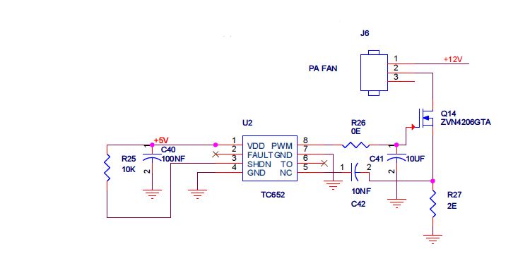

On the 8000 the fan is controlled by a PWM fan controller IC located on the power amplifier board. Here is a schematic snippet:
You can unplug the fan from J6 and wire it directly to 12V so that is always runs full speed.
