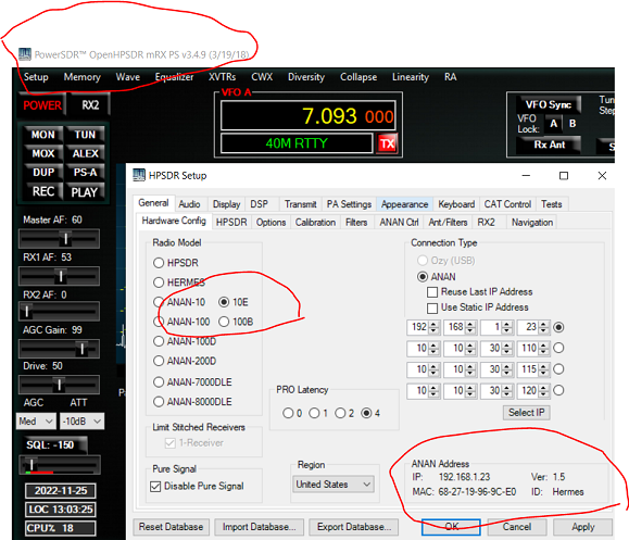

I received a special production Hermes 14 bit board yesterday.
The firmware installed is Protocol 1 Hermes v1.5. With this firmware, PowerSDRmrx3.4.9 as well as Thetis v.2.8.11 are working apparently. But Thetis v2.9.0.6 does not work.

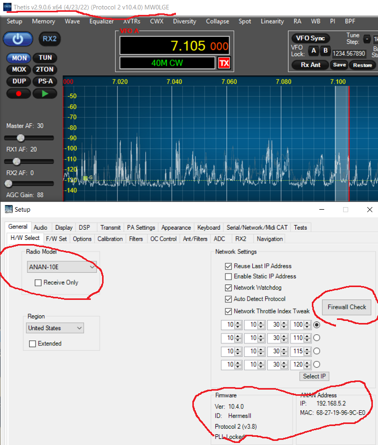

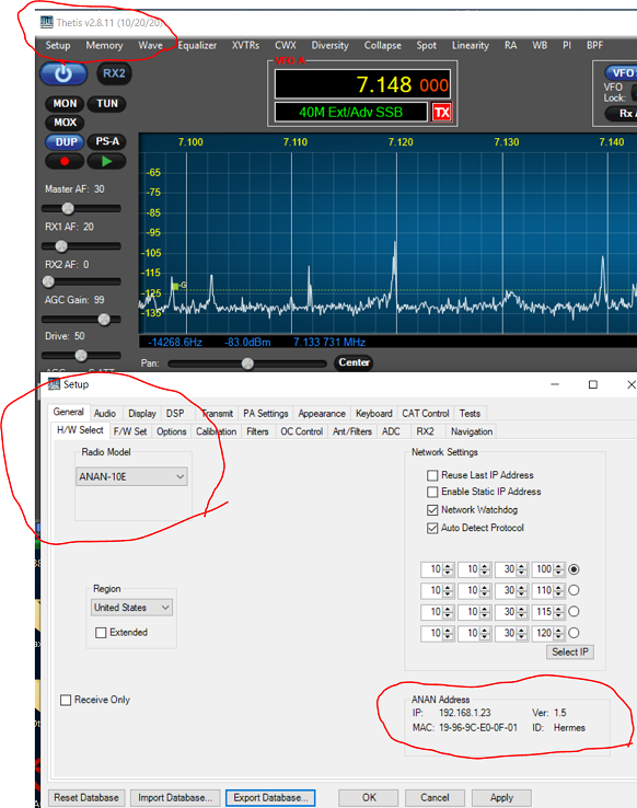

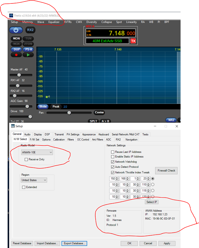

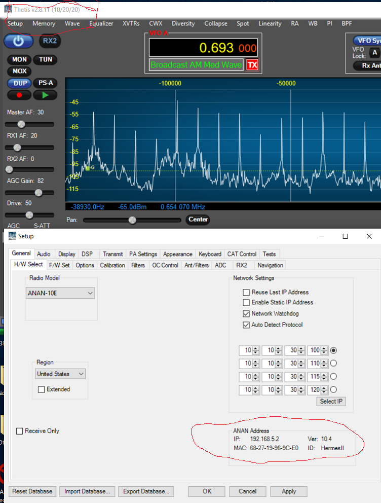

As for Thetis 2.9.0.6 with 10E, please look at the following screenshot.
Thetis 2.9.0.6 is dumb without any response, no spectrum. On the contrary, Thetis 2.8.11 is working. As for the MAC address, both Thetis show a strange MAC address. PowerSDR displays the correct one. I'll try the firmware update to Protocol 2 of my Hermes 14 bit 10E.

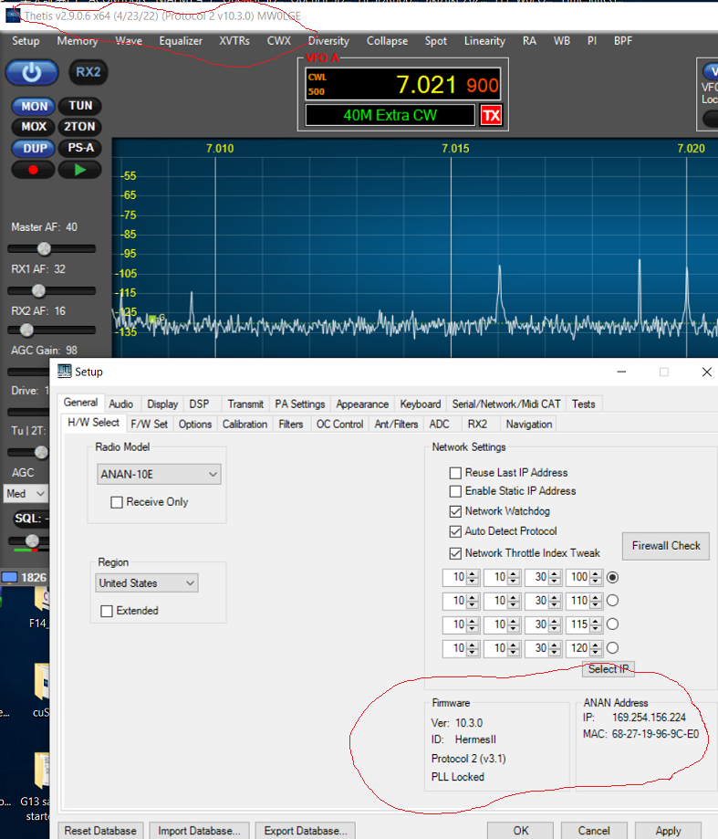

I have done test( only for receiving) here in my environment. The result is the following:
<<10E Firmware ver10.4_pre2>>
Thetis 2.8.11 works apparently fine .
Thetis 2.9.0.6 works, but VAC not. This is the same as the firmware10.3.
<<10E Firmware ver10.3>>
Thetis 2.8.11 works apparently fine.
Thetis 2.9.0.6 works but VAC not.
One thing very strange is the IP address. 10E shows IP address APIPA like, 169.254.156.224. Please look at the screenshot. This firmware is very unstable as a whole.

Re: 14-bit Hermes (10E and 100B) Protocol 2 Firmware Topic
Tokio,tok2010 wrote:Hi group,
The conclusions you are drawing from your results are incorrect.
The reason you are having problems with P1 and Thetis 2.9.0.6 are almost certainly because of Windows firewall problems on your PC. Use the Firewall Check button in Setup > General > H/W Select.
Problems with VAC can have nothing to do with firmware or hardware. VAC functionality does not extend outside of Thetis. Many hundreds or even thousands of users are using VAC with 2.9.0.6 with no difficulty. You must have a configuration problem in Thetis or elsewhere in your system.
However, the one thing you did get correct is that P2 firmware on the Hermes 14-bit platform is extremely unstable. It will not work on all serial numbers. But 2.9.0.6 with P1 firmware does work 100% fine.
