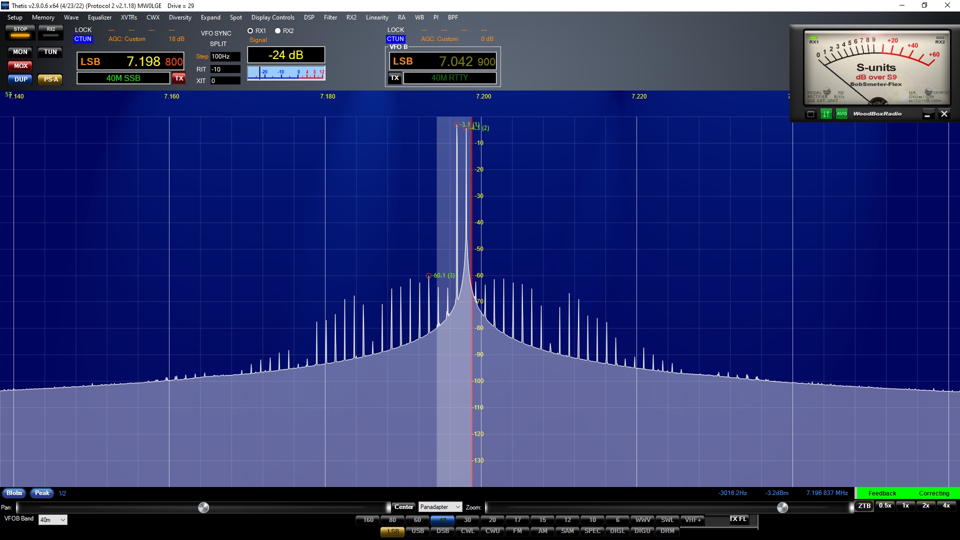

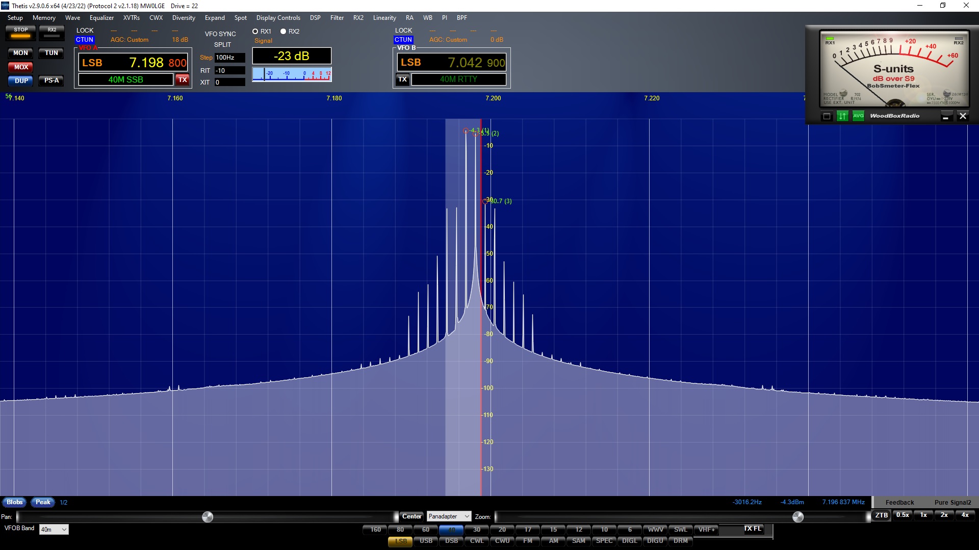

Three weeks ago, I received an RF-Kit RF2K-S amplifier. 2T IMD performance compares favorably with my Alpha and ACOM tube amps and about 10 dB better than my SPE 1K-FA amp.
The attached images show typical 2T IMD at 1500W from the RF-Kit amp using an Xtronic coupler. I don't normally use it and prefer a capacitive divider, but the result is the same no matter which type of sampler is used. Using an external sampler and not RF-Kit's internal sampler allows me to select one of several desktop amps without having to change sampler cabling.
- RF2K-S PS-On 40m 1500W.jpg (324.51 KiB) Viewed 9306 times
- RF2K-S PS-Off 40m 1500W.jpg (316.25 KiB) Viewed 9306 times
