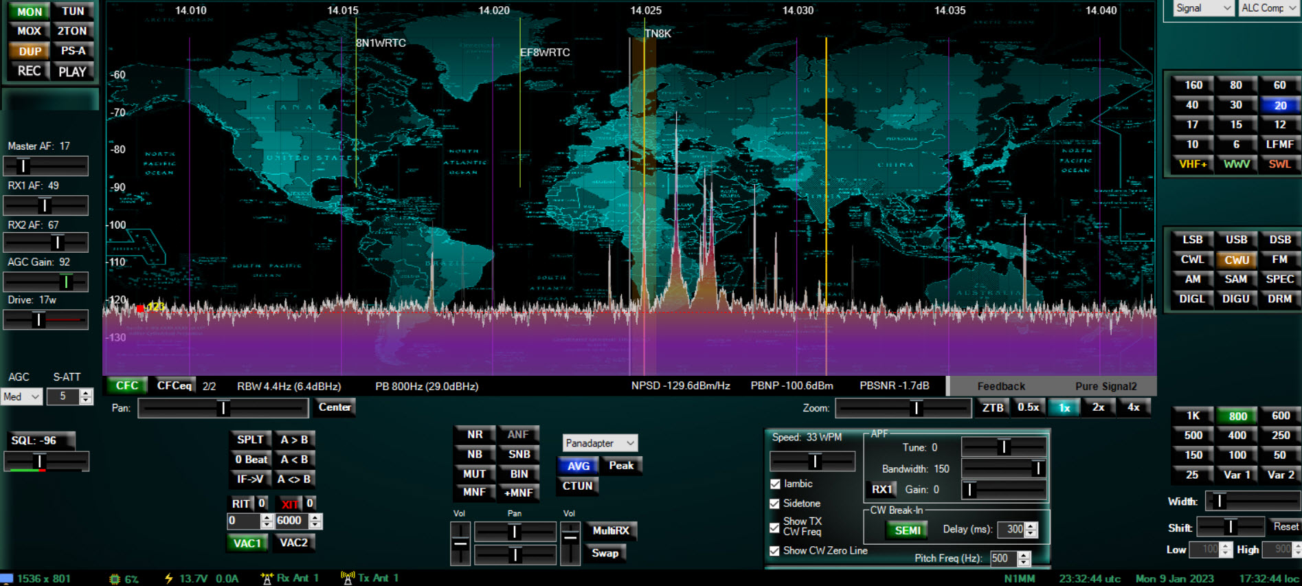

Was working SPLIT on CW just now, trying to snag TN8K and when I key the TX, my TX frequency appears to be roughly DOUBLE the XIT frequency. In this case I was transmitting 6kHz up, but when I key the radio, the display seems to show my CW carrier at around 12kHz above. I know for a fact that I am transmitting only 6kHz higher (used another radio to verify).
UPDATE: I forgot to mention that I've never seen this before :roll: . Or, perhaps I just didn't pay attention (I tend to not think this either as I am pretty careful when working SPLIT), but it is disconcerting to say the least to observe the "discrepancy."
See screenshot below:
Split op TN8K.jpg (449.32 KiB) Viewed 6381 times

The RX passband and TX freq appear to be exactly 6KHz apart. What am I missing?

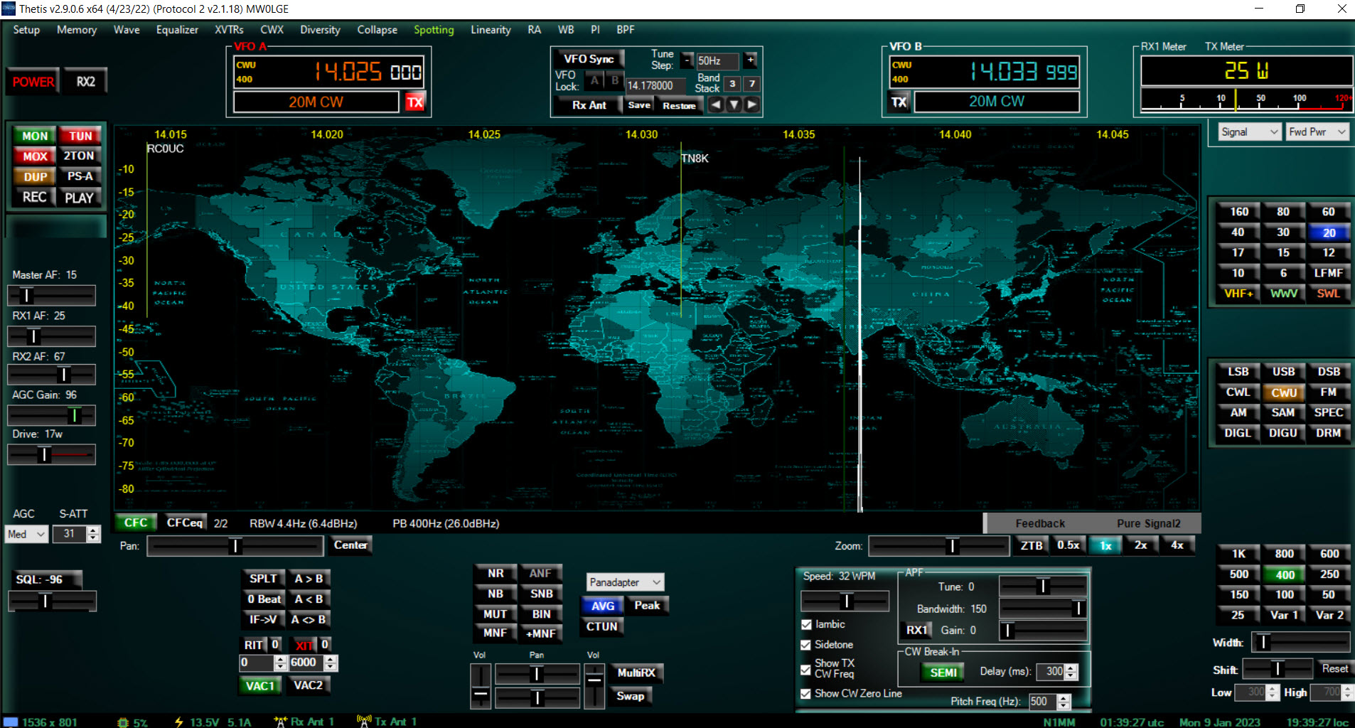

I can confirm this happens - but it's a bug in the panadapter scale (frequency) markings, not in frequency control. Evidently when you go into transmit, it adds the XIT offset to the frequency scale. You actually do end up transmitting where you intended, 6kHz up, but the display shows it incorrectly as 12.
To confirm this I used an external receiver to test your scenario. I used a 6kHz XIT setting. When in transmit the panadapter showed me as being up 12kHz but on the external receiver my signal was actually up 6 kHz.
So, apparently the transmitter is doing the right thing but the display is lying to you about the frequency.

Here's the display with actual key press when using 6 k SPLIT. TN8K was actually on 14,025.00 when I worked him. The screen capture puts him 6 kHz higher than the 14,025.00 kHz (14,031.00 kHz) and "consequently" my TX frequency shows 6 kHz higher than 14,025.00 when I transmit, looking more like 14,037.00 for my TX frequency
Perhaps I should take a nap as I am seeing things. This can't be right..... :roll:
Key press on 6k SPLIT.jpg (512.36 KiB) Viewed 6355 times
