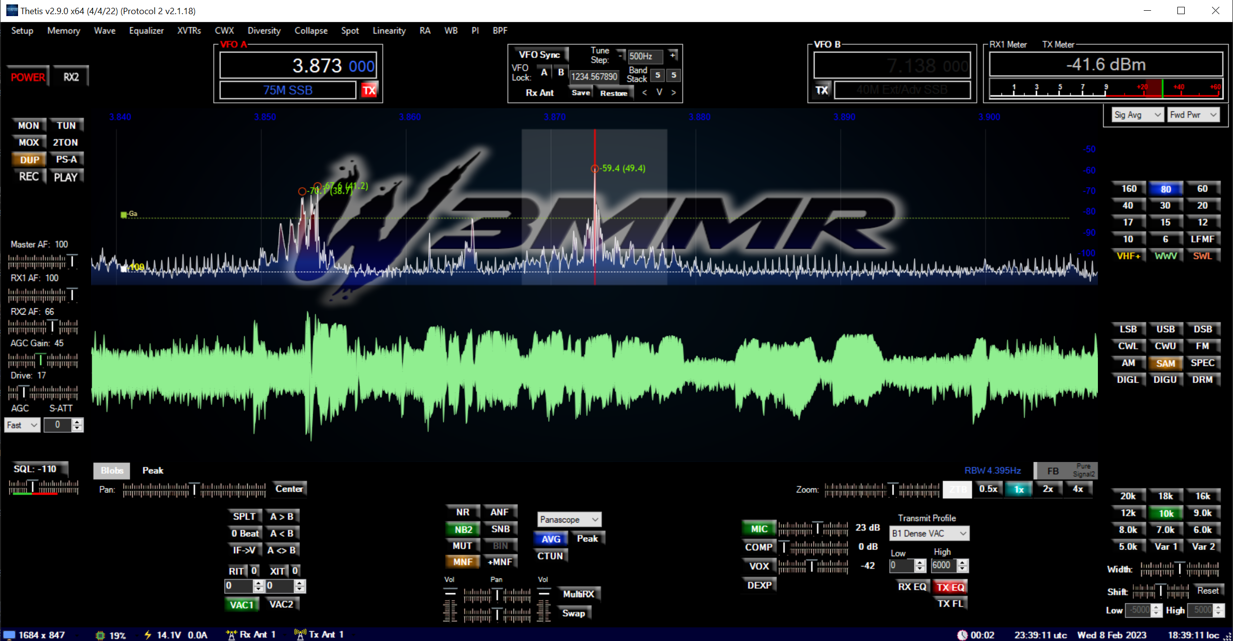

Im not seeing this on my software. Is it in later versions than 2.9.0 x64? All I see is on Page 1, how many hz off listening frequency strongest signal is, the db level of that signal in reference to the grid on the panadapter, and the frequency of the strongest signal in passband. And page 2 on has the resolution BW by itself.

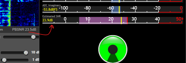

Estimated SNR data is now presented to the meter system and rendered. Difference in numbers is due to the meter being updated much faster (adjustable) than the relatively slow snapshot on the info bar. Oh, and the magic eye is displaying signal str at the mo, well it can be calibrated to display anything in all actuality.

Beware however, that it uses the estimated noise floor across the whole visible spectrum (the same noise floor that used for auto adjusting agc gain etc) and estimated passband noise power to make the calculations. There are a whole bunch of other factors that will change the estimated PBSNR value as well, which perhaps Scott could cover in another thread if not already.

The estimate is extremely accurate, thanks to Richie's remarkably astute algorithm, I believe the same one that is used to judge the noise floor for automatic display scaling. It is rarely more than a dB off.
