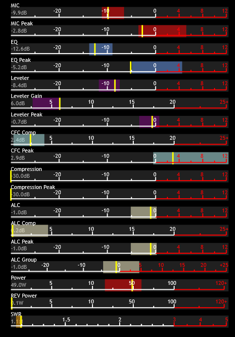

Very cool Richie.
However, can the the peak and average indications for each function please be combined onto a single meter? It's much easier to read and understand that way. It's how audio information is always presented in the professional realm.
Also, there's no reason to show ALC, ALC Comp and ALC Group. ALC Group is all that is necessary as it combines the functions of ALC and ALC Comp.
Re: Meter work
@Scott , yep anything can be done, it is entirely object based with z order etc etc. I can overlay the peak date at a higher Z order easily. At the mo it is everything slapped on dx surface so I can check it all works

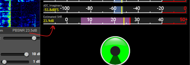

Is a S/N Ratio meter in the future at any point? IMO a S/N Ratio (SNR) meter is actually much more relevant than a simple S-meter because it actually shows the signal level relative to the noise level, which is much more valuable info than just the raw S-meter reading of a signal.
I've always believed that telling someone "You're 10 over" (but not mentioning that the noise is already S9+5) is nowhere near as informative as letting them know "You're only 5 dB over the noise".
For reference, the latest version of Simon Brown's SDR Console has a fully functional SNR meter, it performs beautifully, I use it all the time while SWL'ing.

It's not a meter, just a readout, but that information is currently available in the "info line" just below the spectral display. Right click that line to switch between the two pages of info available. Page 2 of 2 shows resolution bandwidth, noise power spectral density, passband noise power, and passband SNR. These numbers are all approximate since the software has to guess where noise is noise and where signal is signal, but they are pretty close.K1LSB wrote:Richie,

Estimated SNR data is now presented to the meter system and rendered. Difference in numbers is due to the meter being updated much faster (adjustable) than the relatively slow snapshot on the info bar. Oh, and the magic eye is displaying signal str at the mo, well it can be calibrated to display anything in all actuality.w-u-2-o wrote:It's not a meter, just a readout, but that information is currently available in the "info line" just below the spectral display. Right click that line to switch between the two pages of info available. Page 2 of 2 shows resolution bandwidth, noise power spectral density, passband noise power, and passband SNR. These numbers are all approximate since the software has to guess where noise is noise and where signal is signal, but they are pretty close.K1LSB wrote:Richie,

Beware however, that it uses the estimated noise floor across the whole visible spectrum (the same noise floor that used for auto adjusting agc gain etc) and estimated passband noise power to make the calculations. There are a whole bunch of other factors that will change the estimated PBSNR value as well, which perhaps Scott could cover in another thread if not already.K1LSB wrote:Richie, you are awesome !!

The estimate is extremely accurate, thanks to Richie's remarkably astute algorithm, I believe the same one that is used to judge the noise floor for automatic display scaling. It is rarely more than a dB off.ramdor wrote:Beware however, that it uses the estimated noise floor across the whole visible spectrum (the same noise floor that used for auto adjusting agc gain etc) and estimated passband noise power to make the calculations. There are a whole bunch of other factors that will change the estimated PBSNR value as well, which perhaps Scott could cover in another thread if not already.K1LSB wrote:Richie, you are awesome !!
