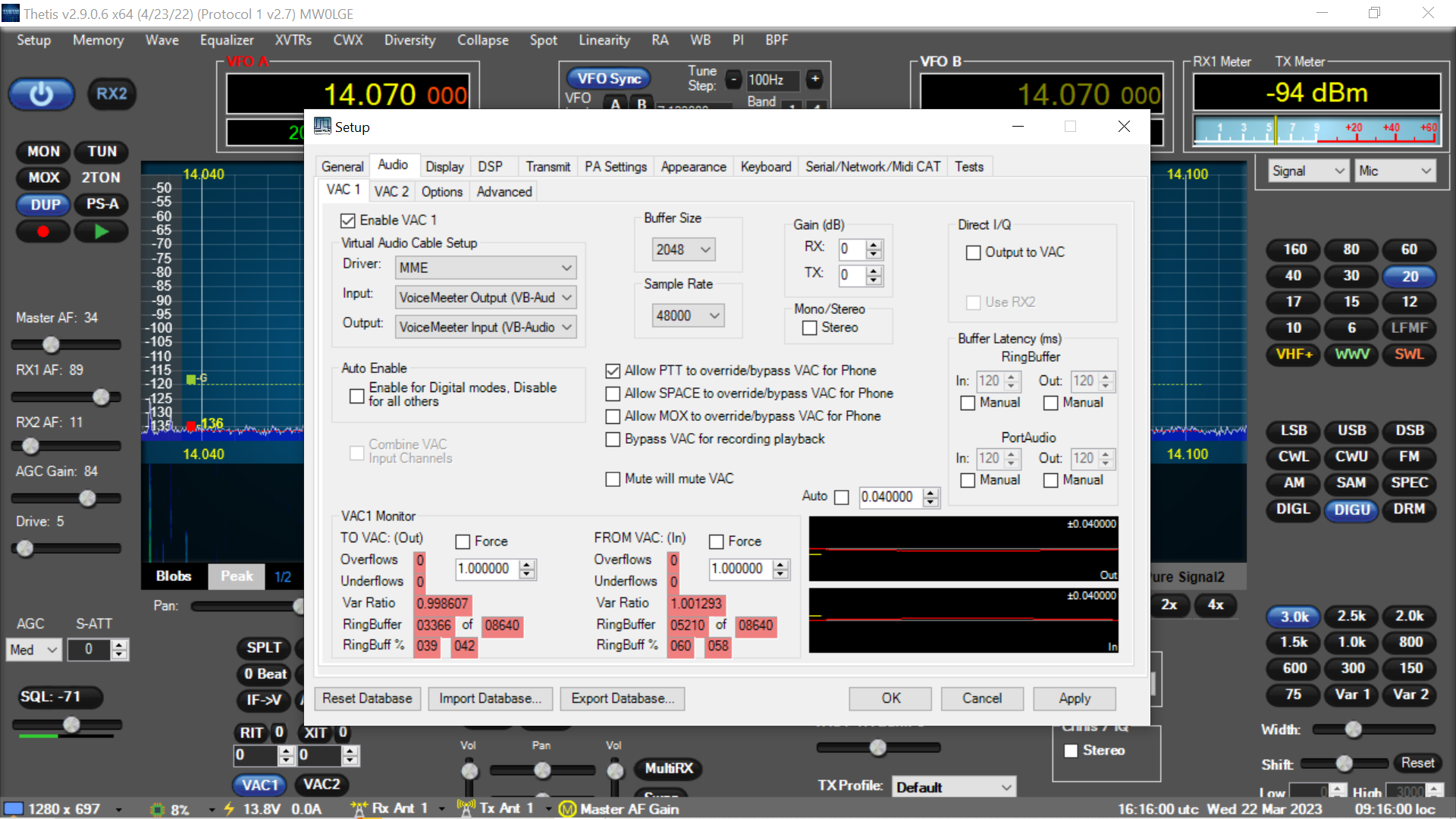

Hi Tom, can you post a screenshot of your audio settings on the radio software please ?

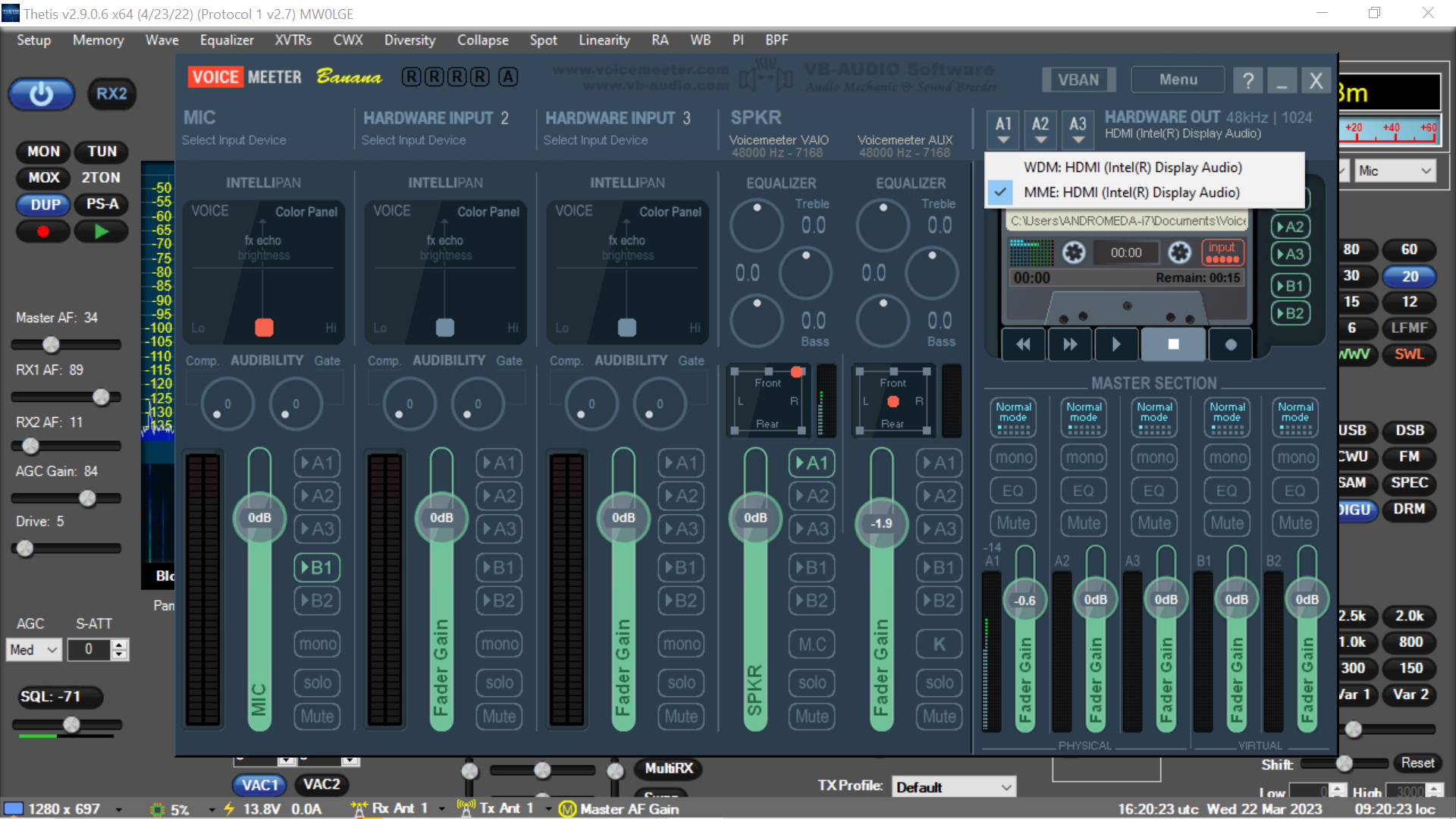

Tom--you must first set the A1 hardware output in Voicemeeter even if you don't plan on using it. It's a strange limitation/requirement of Voicemeeter.

Scott and Tony, thanks for the replies. Here is the screenshot requested. Scott, I had already tried your suggestion with no luck.
i'll try to send a screenshot of the VM showing the options I have to choose from there. First is the Setup>Audio
download/file.php?mode=view&id=3442
Second for Scott, the VM. if that is not what you need, I have others.
download/file.php?mode=view&id=3443

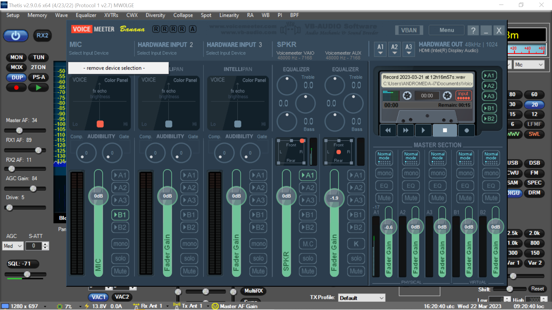

I'm not following you.....here is another screenshot showing the result when I click the MIC tab to get a dropdown list....."Remove device selection"
What do I need to do in order to produce a dropdown list instead of the "Remove....." popup? Where does the microphone list come from...how do I find the microphone. The only thing I have in the way of microphone hardware is a headset plugged into the front of the Andromeda.
I guess I don't understand the audio input/output flow (path) before it gets to VM.
download/file.php?mode=view&id=3449

OK, my bad, based on your previous posts I thought this was a digi mode problem (maybe it will be in the future
The problem you may be having is that perhaps you don't understand that software can only see audio devices plugged into the PC. Anything you have plugged into the Andromeda is only visible to Thetis.
Now I'm assuming you want to use a mic plugged into the PC. So plug one in and then it will become visible to Voicemeeter. You may have to restart Voicemeeter in order for it to detect any hardware changes.
You can use any USB microphone you might have.
And if that is still leaving you lost, then you need to explain exactly what it is you hope to achieve, and how you think it should be achieved.
