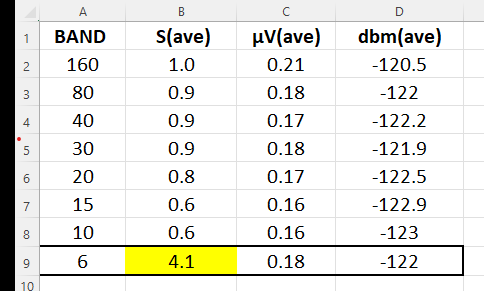

The S meter reading on 6m looks anomolous cf other bands for comparable uV/Dbm readings (see table).
Comparison of readings across all bands was done using same bandwidth/mode (3Khz/USB) and all antennas disconnected with exception of small dummy load on acitve antenna port.
Screenshot 2023-03-24 121156.png (11.15 KiB) Viewed 4433 times
My expectation was that with no antenna/limited external noise the Smeter would be in the 0-1 range on all bands. Which it is, except on 6 meters. Switching the 6m LNA in/out made no significant difference.
I assumed the Smeter reading was calculated/interpolated from the actual voltage reading on the ADC - so that relationship shouldnt change with frequency/band.
Looking through the Thetis Manual and the 8000 manuals I couldnt find anything band specific on S meter calibration.
Note - The physical readings look fine (dbm/uV) Im not quibling about the physical calibration of the rig - just the S meter calcs on 6 mters.
I dont have a decent signal generator so the best I could do for a comparison across the bands was just active antenna socket terminated in a dummy load for equivalence.
Welcome any comments whether this is normal or why the relationship appears to breakdown on 6m. Is there anywhere in software to adjust this ?

Re: Anomalous S meter reading on 6m band only
Post by DL2XY »
Your values reflect exactly the IARU recommandations for S-meters:
HF: S9 = 50µV = -73dBm
VHF: S9= 5µV = -93dBm
So everthing is perfectly fine.
Walter is 100% correct.
There is an unfortunate issue in that that the IARU left the 6M band in limbo when they laid down the law on this. The original software developers during the pre-Apache days of the openHPSDR project chose to lump the 6M band in with the VHF standard. It has remained that way ever since.
In more detail...
S-meter standard reference levels:
The S-meter standard reference levels are defined by IARU Region 1 Technical Recommendation R.1, as ratified at both the Brighton 1981 and Torrelmolinos 1990 meetings. This standardization is documented as follows:
Code: Select all
STANDARDISATION OF S-METER READINGS
1. One S-unit corresponds to a signal level difference of 6 dB,
2. On the bands below 30 MHz a meter deviation of S-9 corresponds to an
available power of -73 dBm from a continuous wave signal generator
connected to the receiver input terminals,
3. On the bands above 144 MHz this available power shall be -93 dBm,
4. The metering system shall be based on quasi-peak detection with an
attack time of 10 msec ± 2 msec and a decay time constant of at least
500 msec.
Unfortunately, this leaves S-meter reference levels undefined for the 6M band! For 6M, Thetis currently uses the "VHF" reference level of S9 = -93dBm. Whether this is correct or not is hard to say since the IARU didn't define it. But that's the way it is and your hardware, firmware and software are all working as designed.
