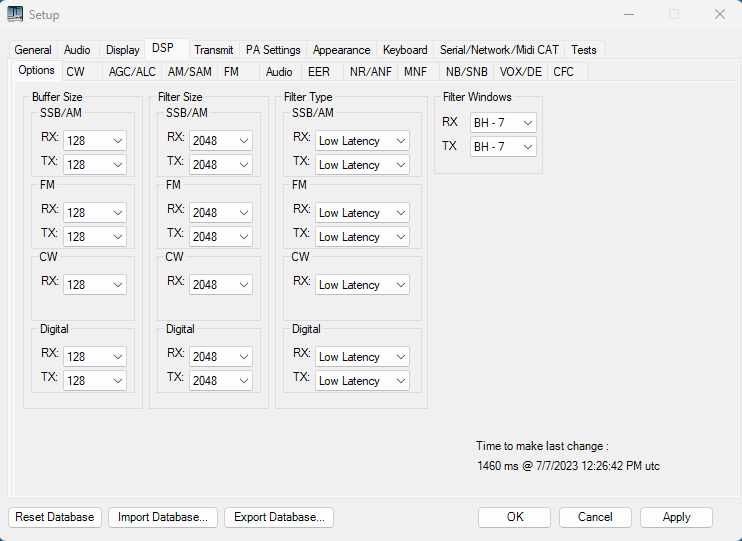

I'm not an expert on filters however, my experience is if the DSP->Options->Filter Size->(RX and TX) SSB/AM is set any higher than 2048, the ringing gets increasingly annoying, Im using Low Latency/BH-7, but Filter Type and Window doesnt seem to have much influence on the ringing. In fact, when I listen to other Thetis stations, the transmit ringing artifact is plainly audible to me, and I usually guess that the transmitting station has their Filter Size (TX) set to 8192 or higher, and Im usually right. So, for what its worth, and Your mileage will probably Vary, this is what I use for virtually no detectible ringing.
Apache 7000DLE Thetis v2.10.0 x64 Windows 11, i9, Nvidia RTX2060
Jeff NJ2US
