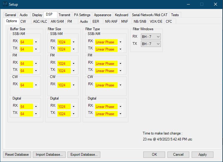

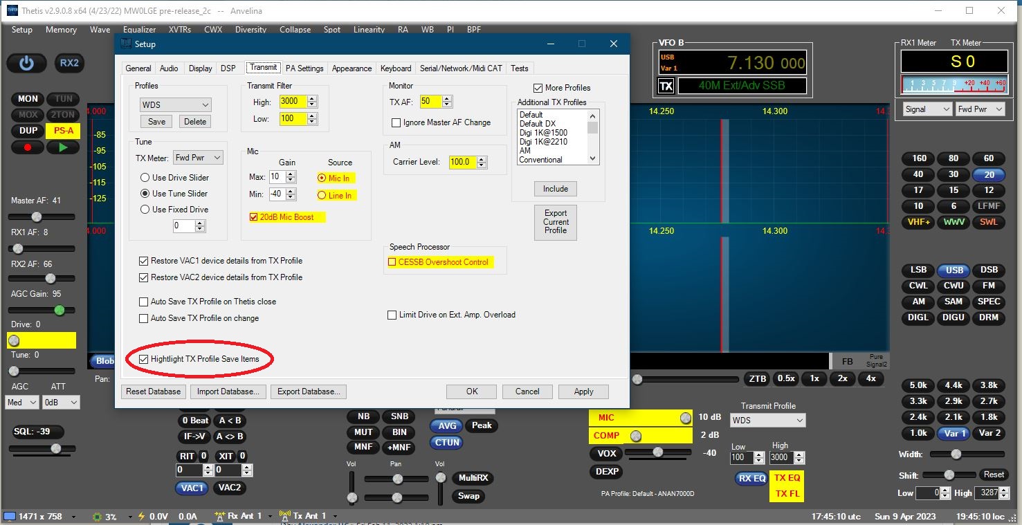

Goto Setup>Transmit and mark "Highlight TX Profile Save Items" and go thru all setup pages to see which parameters will be saved in your profile.
setup 1.JPG (280.83 KiB) Viewed 3471 times
There is more than I have shown here.

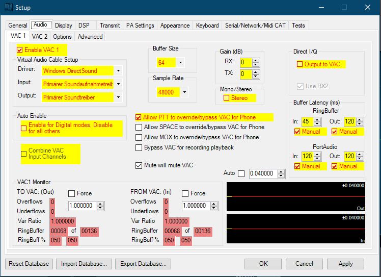

I was curious about your Ring Buffer and Audio Port settings. So, are you not seeing many under/overflows at all?
Also, people tell me that numbers in the IN and OUT boxes should be the same although I am not sure if that is a requirement.
There was a video about these settings, not sure if MW0GLE put it out, but I would like to locate that video again.
Update: I found it and Scott has one too.
