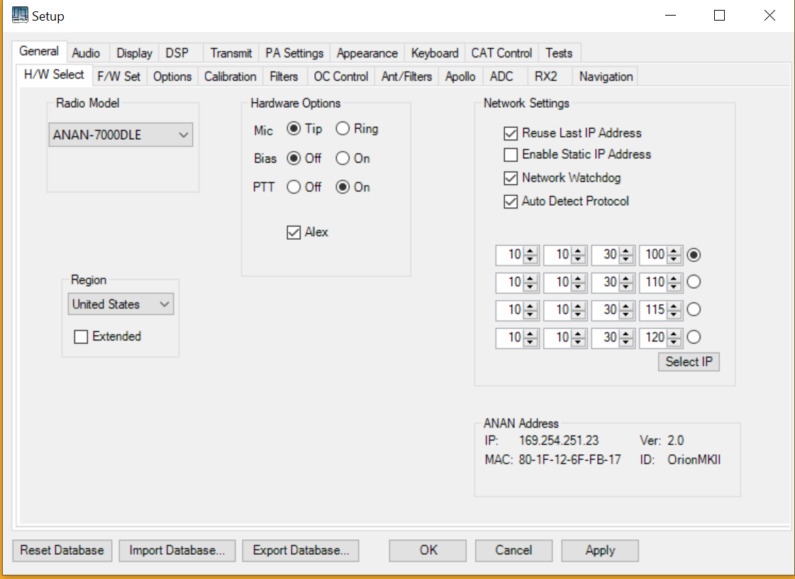

2. I am not 100% sure what firmware version that I'm running as I've yet to find an Anan user with setup tab information that is formatted like mine. So, I've attached a screen capture from the Setup menu to get your feedback. Specifically, the tab does not indicated explicitly protocol 2. The H/W select tab reads as follows: Ver: 2.0 and ID: OrionMKII (See attachment). Does this mean my firmware is version 2.0? Or, is this an indication of protocol 2? Whenever, I ask on-air users about this information they seem perplexed at my observation and indicate their tab has more information than mine.

- HW Select.PNG (131.19 KiB) Viewed 10769 times
