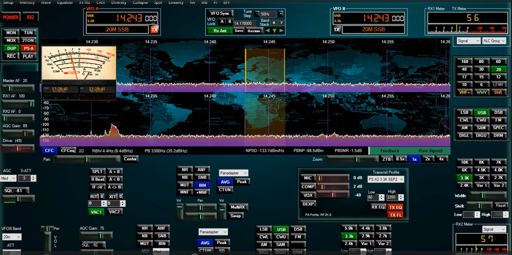

As I had reported quite extensively many weeks ago, RX1 exhibits a strange anomaly - noise floor dropping and then bouncing back several times in a row (regardless of band or antenna) whereas RX2 does not. The radio was looked at by Doug, W5WC, without any resolution although he tried as hard as he could. He even replaced the PA/Filter board. I think I also mentioned to him that RX2 behaves as expected, steady as a rock. I just emailed him this screen capture - actually, a video capture- (you can see the drop-off in noise-floor towards the end).
Two images below.
Two images below.
- RX1_RX2 After.jpg (350.48 KiB) Viewed 24581 times
- RX1_RX2_Before.jpg (348.87 KiB) Viewed 24581 times

Looking at your spectrum displays, it's apparent that the S/N ratio in RX1 isn't as strong as RX2. I'm curious why that is, and what specific antennas are feeding each receiver?
Edit: Can you swap the antennas on RX1 and RX2 and post another snapshot?

UPDATE: Images below (swapped antennas)
RX1 had an End-Fed-Half-Wave connected and RX2 is using an inverted V dipole at 33'. I will do the "swap" and post tomorrow.
When it comes to signal strength, depending on where the station is, there can be a difference of 2-3 S units when I bounce between the 2 antennas.

And before you grab the snapshot, please move the big MultiMeter out of the way so the dB scale on the left edge of the RX1 display is visible, as I want to verify that the dB scaling is the same on both receivers.JJ4SDR wrote:Mark,

I know what you are saying, but regardless of the scaling (it is a tad different, I noticed), the noise floor sinks very low, AND, the floor goes up and down so even with slightly different scaling (I will make them the same), it is obvious that something isn't right.
UPDATE: Matched scales

Re: RX1 acting up whereas RX2 is not
I have AC, but I don't run it always upstairs. By the way, Phil, VK6PH wrote to me yesterday saying "It gets to over 100F in my shack and I have remote access via the Internet so its not a temperature issue."
It just hit me, you specified in a Firmware related post (Jan 16, 2023 UPDATE) that "ANAN-7000DLE MKII, no serial number or serial number lower than DX8300497A" - MINE is - that my hardware would need to be flashed to v.2.1.18 when using Protocol 2. Now, Doug put in a new PA/RF board which makes me wonder if, in fact, I would need to now flash v.2.1.26c instead? Will I BRICK my new hardware IF I flash the v.2.1.26c?
You see, I purged out Thetis and OpenHPSDR from my PC (I even uninstalled npcap and Bootloader and then re-installed both) and decided to start "clean," in hopes of getting it all to work again.
Leon,
Doug, W5WC, put in a new PA/Filter board so I would think that all relays got changed too.
Leon,
The new RF board has nothing to do with the FPGA, which is on the Orion board. Firmware will therefore not change.
Loading the wrong firmware will not brick anything, but it won't work, either. Just load the right stuff with Bootloader.
Someone else running at elevated temperatures is promising but there is still enough difference between units that yours could be effected where others are not.
Do the P1 experiment.
I read you Scott!
One more "foolish" question. Will the latest Thetis version (2.9.0.8 - Pre-release) care whether I run P1 or P2? I assume that doesn't matter.
Thanks. Will do the experiment.
Chris,
I am glad you haven't dozed off at the litany of questions and exchanges on this
No, I haven't tried any other Protocol versions, but as Scott is suggesting, it may be time to try Protocol 1 for a look-see and it that remedies this anomaly I am fine with that
I should also have added that it is unlikely in the extreme that you would have two faulty RF boards in a row.
This sure continues to seem like a thermally related P2 timing closure issue. If P1 works it's practically a slam dunk indication at this point.
It sucks that it seems you have more of an outlier case of hardware compared to Phil. Given the limitations Rick has been faced with for firmware development (single board to test on, no hardware characterization data from Apache, lack of incremental build in Quartus Lite, etc.) it's not unexpected.
No joy.
Rolled back to Protocol 1 and both RX1 and RX2 exhibit the same abrupt drop of noise floor after about 5 minutes. Floor sinks and bounces back to "normal" over a period of 1-2 minutes and this keeps happening once it starts. For the first 5 minutes, all looked good but I got my hopes up too early.
I guess the next step is to roll back to the Thetis version (2.8.11) that I used when I first started using the radio almost 2 years ago. Or perhaps I first try another PC (it is an old lap-top with an Intel i5 CPU that I think has 4 cores) and see what happens. If I am still seeing the "ebb and flow," I may take Mark up on his kind offer to take the radio to his shack.
